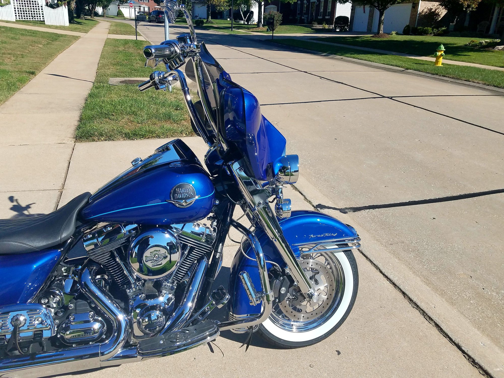

i have a Dead Center Cycles fairing. I've noticed no difference in handling. It has good manners from parking lots to interstates. Cruises fine at 80

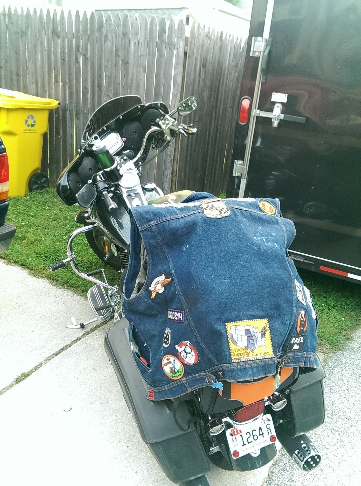

I installed a Woody fairing on my 09 RK. It came with the inner fairing, 4 speakers, stereo and cigarette lighter and it is made of gelcoat fiberglass. It really help with wind when compared to the standard RK windsheild. As good as it was, I still put in a recurve windsheild and the little louvre fins on the lower edge of the fairing. I finally installed fork fangs because the curve in the lower side of the batwing would channel a vortex straight to my gut. Now I have dead calm air in front of me and makes long rides less punishing.
The downside to the fairing on a RK is 1) it makes steering heavier than the stock windshield and 2) cross winds are still a hazard. The upside is that I was able to move the fairing over to my new '17 RK with ZERO issues. All in all, I love it and would recommend putting a fairing on.
