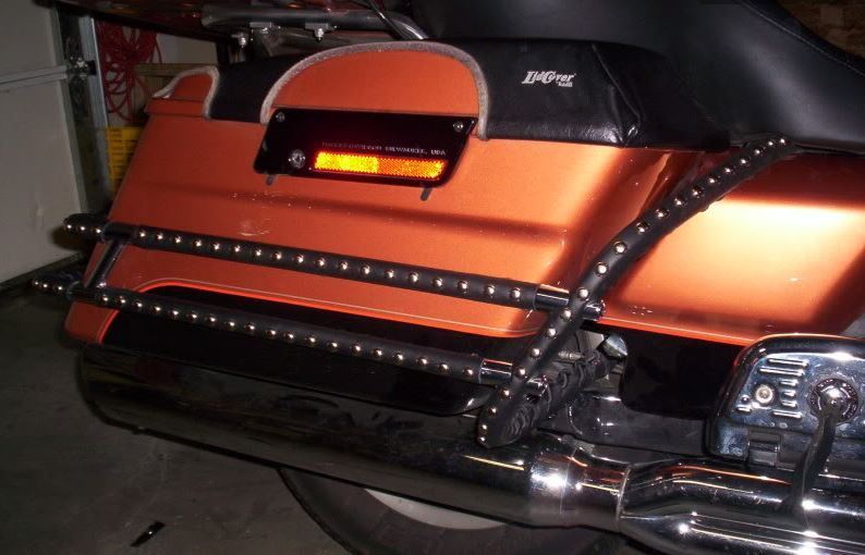

Originally Posted by ICTHDRider
I’d like to keep my saddlebag siderails but I’m being told I can’t with the comfort profile guards. Guess it’ll be worth it for her comfort!
I kept my rails

Originally Posted by dawg
I kept my rails
Those look great! That’s exactly what I’m looking for but having no luck finding any pre-drilled for the side rails. Did yours come that way or did you drill them? I’m being told the pre-drilled are obsolete but hoping I can still find a set somewhere...

Mine were pre-drilled. I got them probably 9 years ago. You can have a dealer run the part number of the obsolete part (49088-01) through h-dnet to locate the part at another dealer that may have it.
