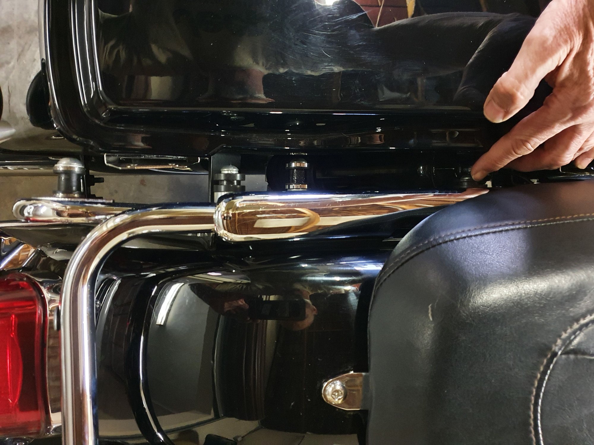

Old Sep 12, 2020 | 09:15 AM
WHS's Avatar
WHS
Joined: Oct 2012
Posts: 337
Likes: 58
From: South Africa
Yes, there are 2 separate sets of docking hardware required.
The front set is for a sissy bar & the rear set for a Tour-pak.
It looks like you only have the rear set mounted on your bike at the moment.
The part # you need is 53803-06.
My finger is pointing to docking point #1, which tucks in tight.
