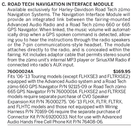

Can a standard 590 be used or do I need a road tech? will it interface with the stock radio and interrupt with prompts? I know the NIM is required. I called Garmin and they claim I can use a standard model. I have a used model I can purchase very reasonably but if its not compatible its obviously not worth it. Ive looked at everything I can here and cant find a definitive answer.

only the harley branded wil interrupt with prompts.

Only the Road Tech units have the ability to interrupt the audio from an alternate source for the voice direction prompts. Standard GPS units will need to be set as the audio source in order to hear the voice direction prompts.
For use on '14 & later, the AUX input wiring & dealer flash to enable AUX input are required. '06-'13 models have front panel AUX input standard, but may require NIM module:
