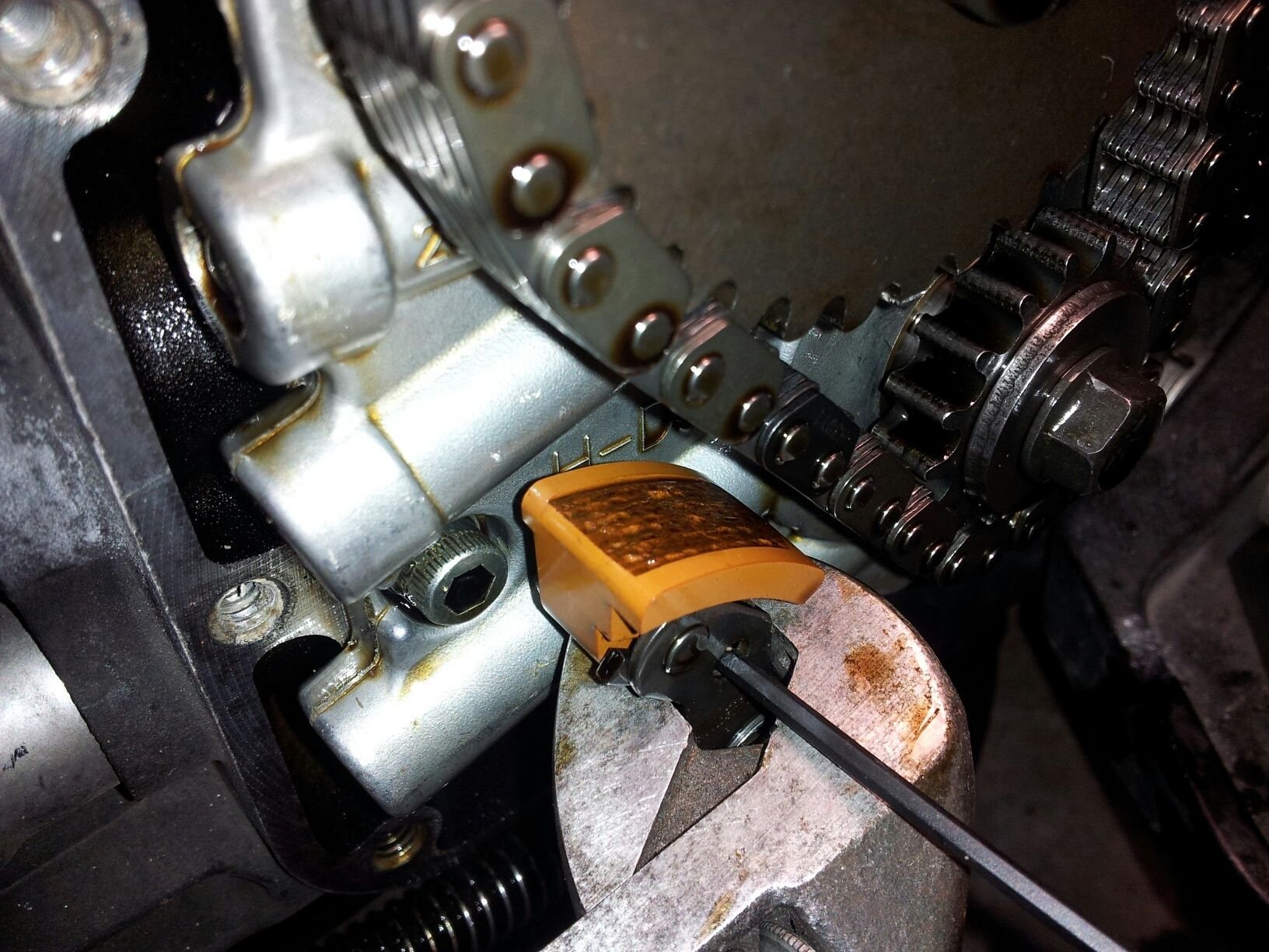

Originally Posted by grubsie
I picked up a beautiful, one owner, 2002 Ultra Classic. This bike is mint, only has 9700 miles on it.
From my understanding, at about 25K miles, it will need to have the cam plate upgrade to hydraulic tensioners so that is one expense I have to figure in.
The cam shoes need to be inspected at 30k, not necessarily replaced. Though you should plan on a replacement of some form eventually....
Somewhat depends on how many miles you log in a year....some shoes go for a while before any issues.
2005 Softail at 90k miles. See the pitting in the orange shoe. Original shoes replaced at 50k.

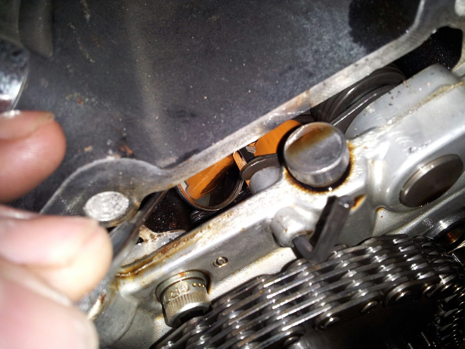

One shoe is behind the cam plate and you need a mirror to inspect it.
