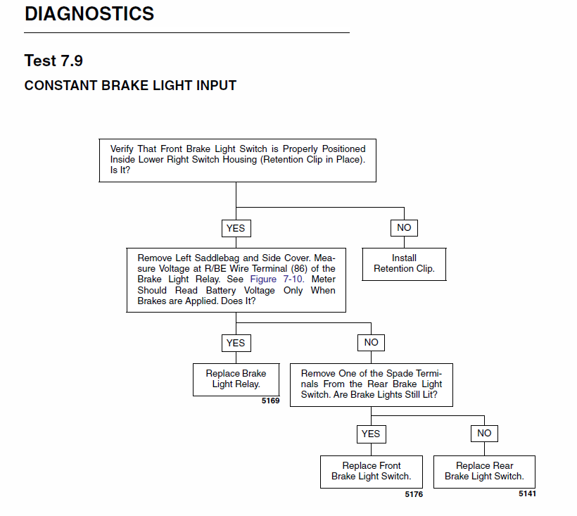

Are you sure that the brake light is not on? It's not uncommon for the front brake light switch to get damaged or misaligned when the switches are removed from the bars. AFAIK the only way that the cruise control would know that the brakes are applied is when the brake light is lit.
From the 2006 Electrical Diag Manual
Code 122 Application of Front or Rear Brakes NOTE May require inspection of brake levers or front brake light switch mounting Follow the chart above.

Check your front brake switch

Check the simple things first...yes, I had the brake lever assembly off while swapping the bars. It easily could have become misaligned somehow.
I did not check the tail light although a more reasonable person would have thought to do so. That's why forums are great.
The diagnosis diagram is cool, I'll have to track it down. Thank you.

If pushing the front brake lever hard against the forward stop turns off the brake light, you probably broke the little plastic button off the front brake light switch. Just about THE MOST COMMON cause of cruise control failure, almost always following a grip or handle bar change. If you have throttle cables, there is a roll-off switch somewhere near the gas tank. Others say to pull the plug off that switch and try the cruise again. If it works, that is your problem. The roll-off is only one of about 4 or 5 ways to turn off the cruise, I never use that feature as it automatically causes a sudden lurch to closed throttle. You would still have the: front brake, rear brake, pulling in the clutch lever, turning off the cruise on the left side switch, and killing the ignition. Pulling the right side cruise switch to coast, or slow down position should disengage the cruise long enough to figure out some other way if needed. I still vote for the front brake lite switch as the most likely culprit. There are "shade tree" fixes not involving switch replacement if that is the problem.

This gets deeper... My brake light is not on inappropriately, and it functions normally using the front or rear brake. I can hear the relay clicking normally. I rechecked my connections at the Deutsch fittings, they are correct.

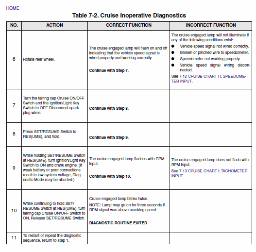

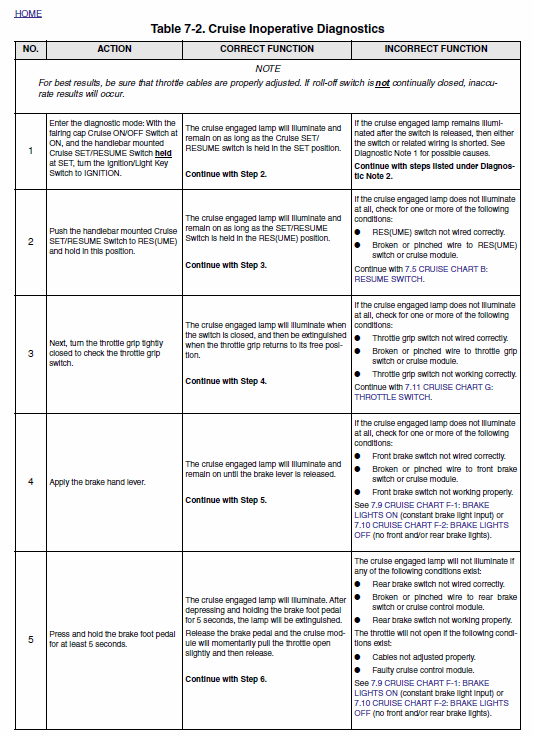

Old Feb 5, 2018 | 07:51 PM
14GuineaPig's Avatar
14GuineaPig
Joined: Sep 2013
Posts: 3,487
Likes: 606
Old Feb 6, 2018 | 09:39 PM

Still hunting for a cause and resolution. Visited with a HD Tech today, his experience - like many here - was to examine the front brake switch and assembly. I took it apart, verified the correct switch operation and wiring. All is perfect there.
I learned that on an '02 the dealer must clear codes but Cruise Control codes aren't like engine management codes and aren't "cleared". They are just present until the fault is resolved, then they disappear.
I got the throw-parts-at-it solution - try a new cruise control module - and the we-don't-know solution - just ride it and see if it starts working. Not much help, really.
There's not many more places to look, I may just wait until riding season here. I will, though, go through the diagnostic chart from 14GuineaPig. Thanks.
