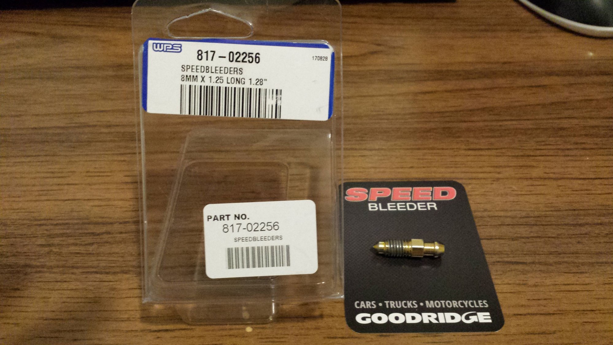

The recall threads have me reminded to flush mine, about 11k miles. I'm sold on the SpeedBleeders concept so prior to ordering, I know I will need 2 packs to get 4 bleeders. When doing the front, is it advisable to crack open both sides and bleed simultaneously? Seems like that would ensure no air trapped. Thanks for any first hand knowledge!

Thanks guys, order placed for the bleeders. Several vendors but the part number stayed the same, SB8125L, as it references the 8mmx1.25 Long for mine. 2 packs=4 so have a spare.

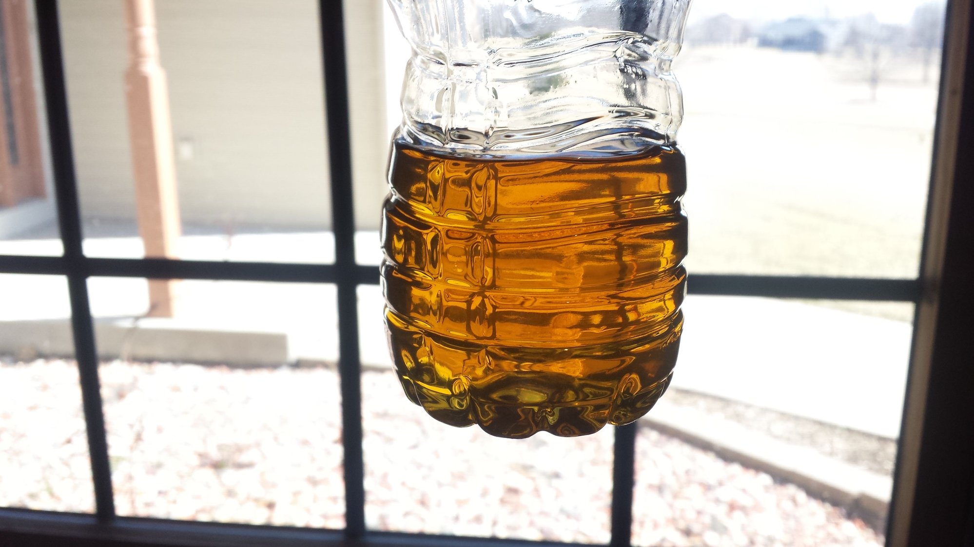

Got around to this project today, went perfect! Total time maybe an hour as being careful to cover everything up to avoid spills. As you can see from picture of old fluid, overdue. This is 4 year old fluid, with the speed bleeders in place, will be every 2 years.
