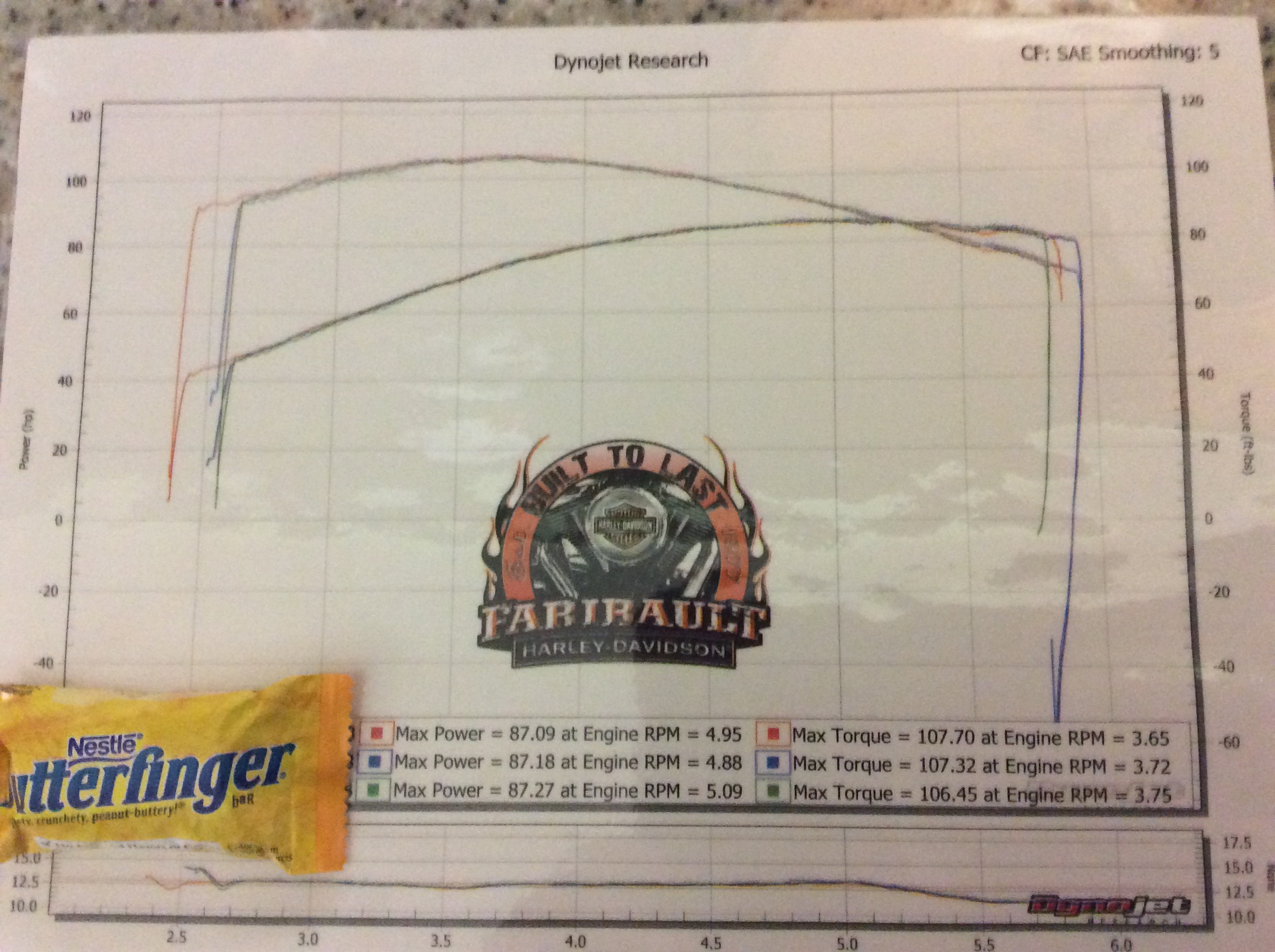

I got a 16 SG. I decided to stay away from cams for now. The money to power gain ratio wasn't there for me at the moment. Here is my dyno graph that was recently done with my set up. Just A/C, header pipes, slip ons and a good tune.

Just to be more specific, I, too, was looking to change cams and wondered if that cost was worth it. From the research I was seeing, the power gains of a cam that was still safe for stock set up wasn't about 8 hp 8 tq gain, maybe.... If I wanted more, then more money would have to be put into the lifters, rockers, pushrods, and the cam itself. I decided that I would save that money and put it elsewhere on the bike.
Good luck with your decision. It is not an easy one at all.
agree based off research cam isn’t worth the money unless you install yourself. Then it’s only like 400 dollars or so.
