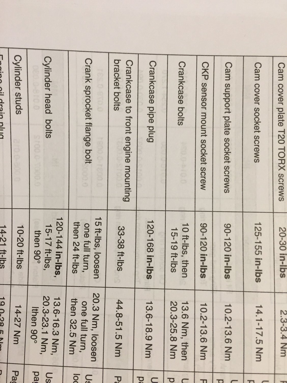

Likes: 8
Default Crankcase pipe plug tourqe??So I had this pipe plug removed the one on the very front of the crank case. I’ve heard horror stories of people cracking the cases by tightening this thing down. Is it OK to talk to you this back is this the correct crank
So I had this pipe plug removed the one on the very front of the crank case. I’ve heard horror stories of people cracking the cases by tightening this thing down. Is it OK to talk to you this back is this the correct crank case pipe plug?
