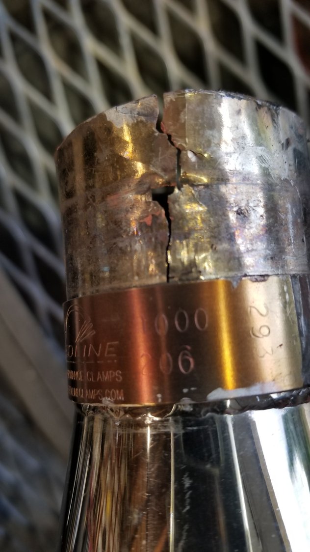

So, I recently bought a set of used Rinehart 3.5" Slip-ons to replace the set I had on my '03 FLHRIC, (95" BB, S&S Cam, and SERT), because the left one had gotten worn paper thin where it slips over the Header. Anyhow, the baffles in the new set had been changed out to 2.5" from the normal 2.25" that are in mine. They sound just a bit softer and deeper then my old ones, and I'm kinda waffling back and forth as to whether or not to keep them or pull my old baffles out and put them in the new cans. Now to the question......... am I correct in understanding that changing out the baffles, even with as little as .25" difference, might/could/should cause re-tune? Part of me thinks that .25" shouldn't do squat but what the hell do I know? I do know if this new baffle set needs a tune, I will no longer be waffling about what to do......... the old baffles are going into the new cans.
