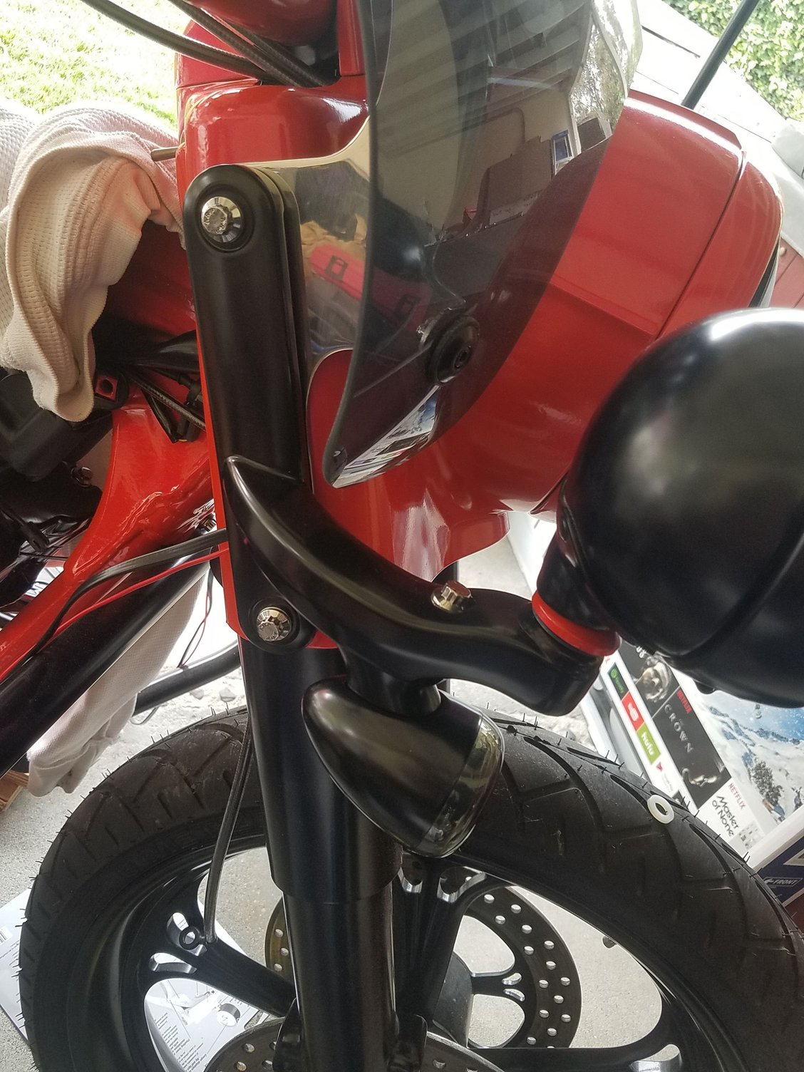

It is a ground issue. I did the same with my '16 RK. The light grounds through the contact of the housing with the mounting pieces all the way back to the frame of the bike. I took mine apart at the mounting and sanded off the powder coat where it makes contact with the support bracket. Then I sanded off powder coat where the support bracket makes contact with the mounting point on the fork. Any little bit of debris or powder coat will cause a flicker or no light. Good luck.
I included the pic so you can see the extent of what I had powder coated.
