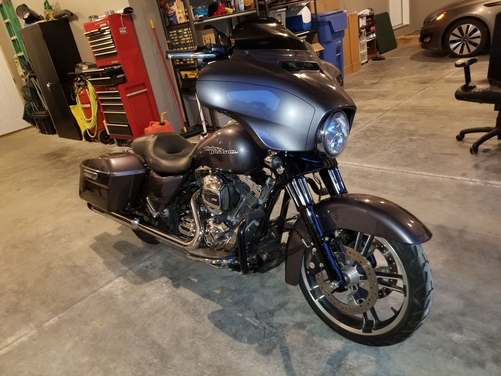

First off thanks to the forum members who helped me get this 15 streetglide fixed up. A lot of the parts are from forum members. I have a few issues. I changed the speedo out bc the bike was wrecked and the speedo was broke. When I hooked it up the following things are displayed:
V Inner
Lw Range
ABS light is on
I fired It up after I re installed the gas tank and I heard a pop or click and it stopped running. Is the different speedo somehow interfering with it running? Is there a way to blank out the error codes without paying the Stealer? If it is a fuse any ideas where to start looking? I have a new battery and fresh gas in the tank.

VIN err is displaying the ECM/BCM/Speedo didn't start off life together. Follow the procedures for "Password learn" and see if that clears the running issue.

Thanks everyone. Pulled the tank off and inspected the fuel lines. One came loose while I installed the fuel pump. It runs fine. I just need to figure out now how to clear the error code.
