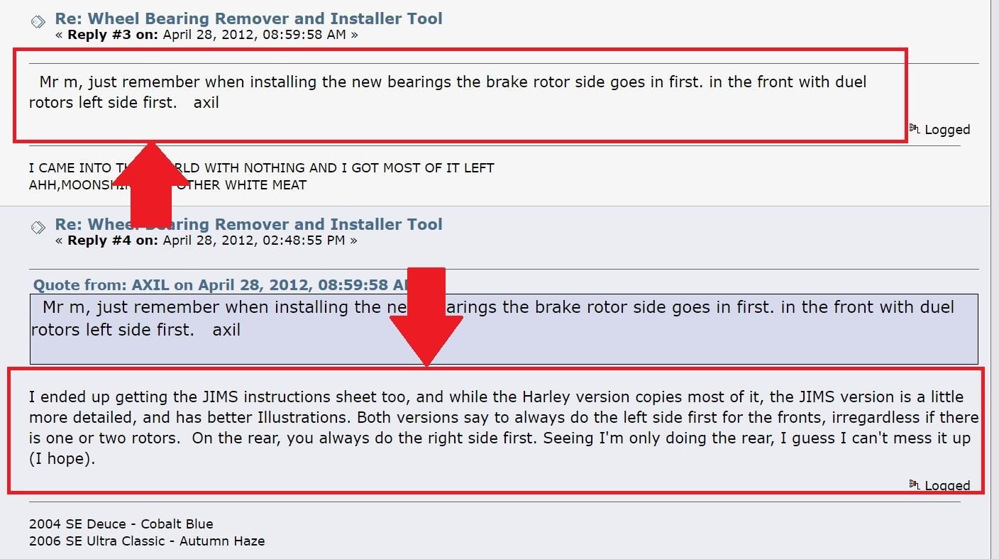

Reading the CVO forum I ran across this....have not seen this mentioned here in any bearing threads I've read here.
What is the reason for installing a specific side first? Thanks.

I guess you haven't read many of my bearing posts ...in fact one addresses the JIMS and Pit Posse instruction Errors explicitly
With very few exceptions (and maybe none on OE wheels), the 1ST/TOP quote is correct...The 2nd quote would be INCORRECT...because it does NOT apply to Sportsters
