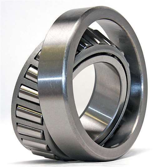

Harley won't admit it...but those are the wrong bearings for the application...ball bearings have no business on a wheel.
If you ride aggressively though curves...which is kinda what motorcycles are for...they will always fail.
They should have tapered roller bearings...which is what Harley's had until 2000.
With minor maintenance TRB's will outlast the bike.
