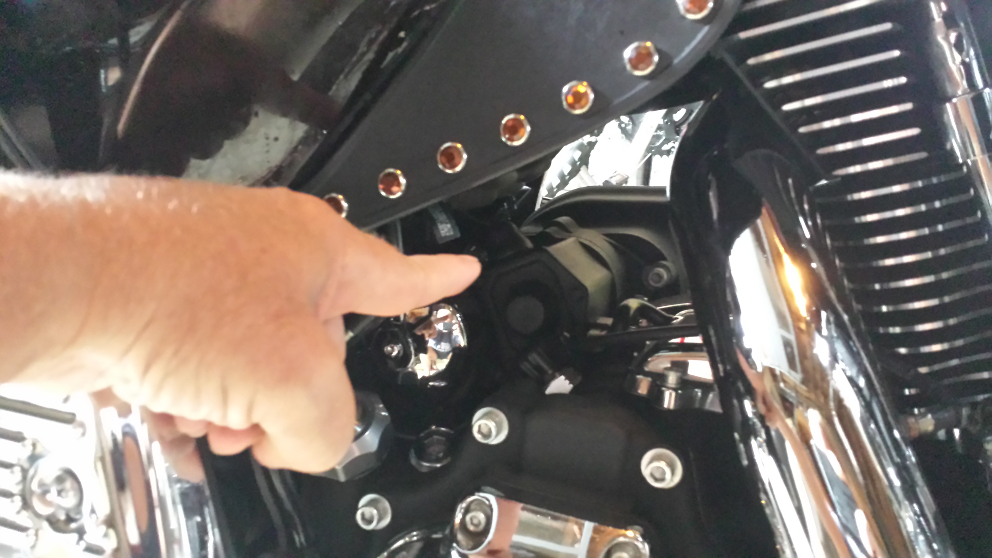

Originally Posted by Vernal
Use the battery positive lug on the starter and any good ground on the frame. No need to remove the seat or get another cable.
you mean this bolt I assume....
Never had to jump but this is def a good tip.
Edit to add: saw this in a post above but read it after I posted.
