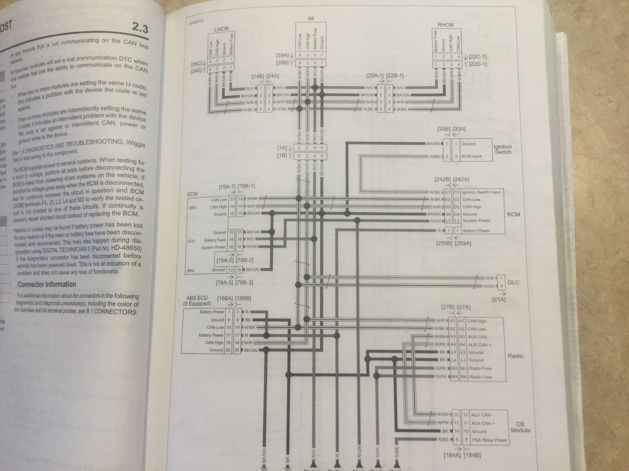

codes showing u0100,p0691,
Loss of communication with ecm and speedo

Use the schematic diagram in post 36 to do the tests.
What a beautiful part of BC you live in.
Just have to ask if you've done any mods that might cause this problem. extended any wires for bars or anything else?

Run the tests you can in post 41, you don't need a breakout box but be very careful not to short your lead to other pins in the connector.
Just to rule this out
