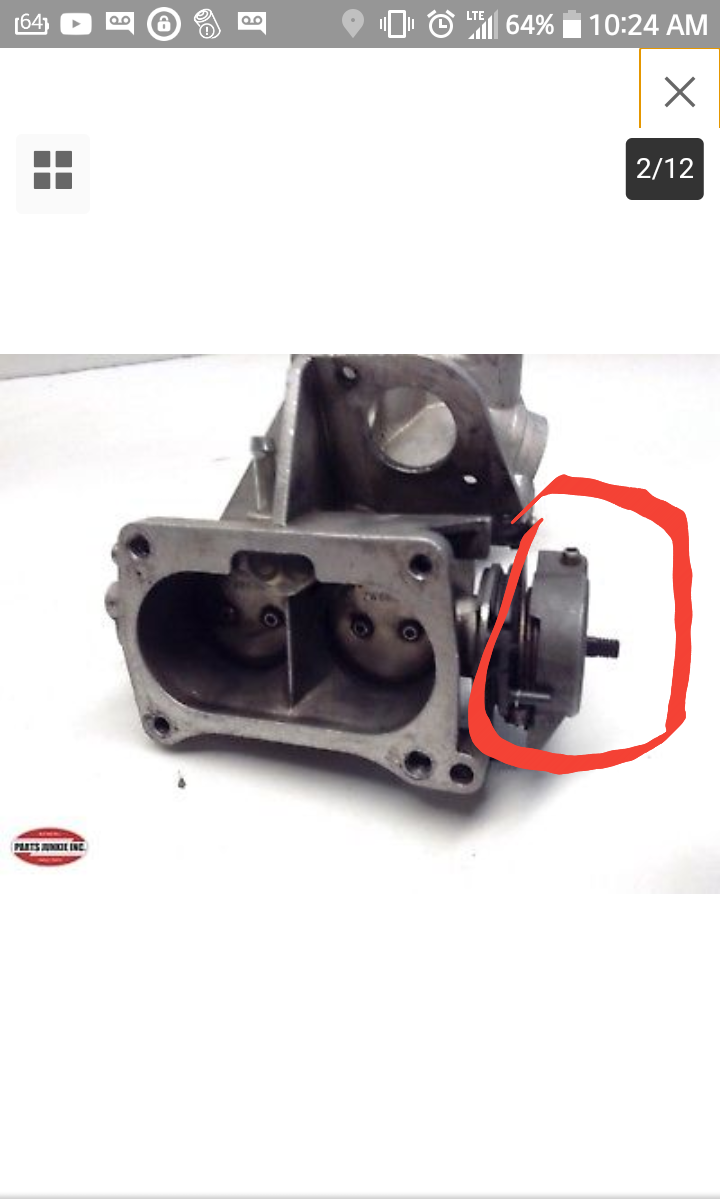

Hi im trying to find out if anyone on here has had the bracket on the fuel injection throttle body come off...mine did and when i went to Harley to get a new one its $100...so i just stuck a nut on the bolt and i have been riding it ...will this mess the bike up? And does anyone know where to get that bracket cheaper?..thanks in advance for any advice

I am talking about the 3-inch bracket that is attached to the bolt at the cover that I have circled

So u need the part marked A? Or it looks like B is what u need

All in the picture or just to the right

It seams to me if you lost the cast part then the other part A most of fell off. So I'm thinking u need A,B and that small spring must of fell off also. Do you still have the cold idle solenoid?

So maybe this is all you nee

I need a and b.. because because it will not idle cold
