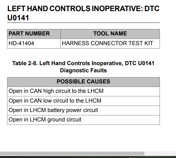

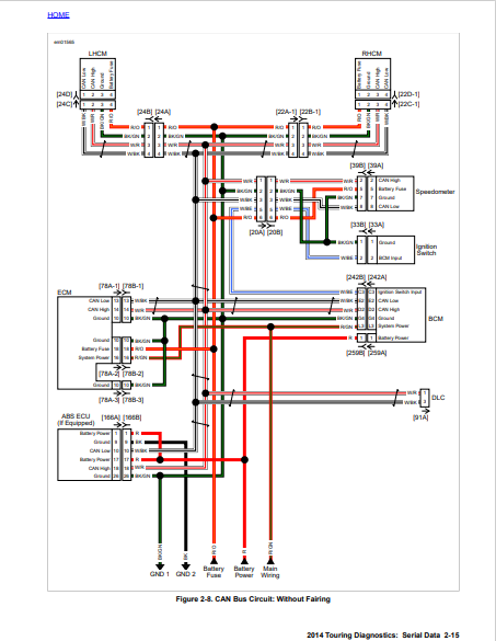

My 2015 Street glide did EXACTLY the same thing after trailering. engine light and red light on. Tried a new switch pack. Same thing. Checked all wiring with no visible issues. Headed to the harley shop Monday for a diagnostic.

Here are a few tests to run:
