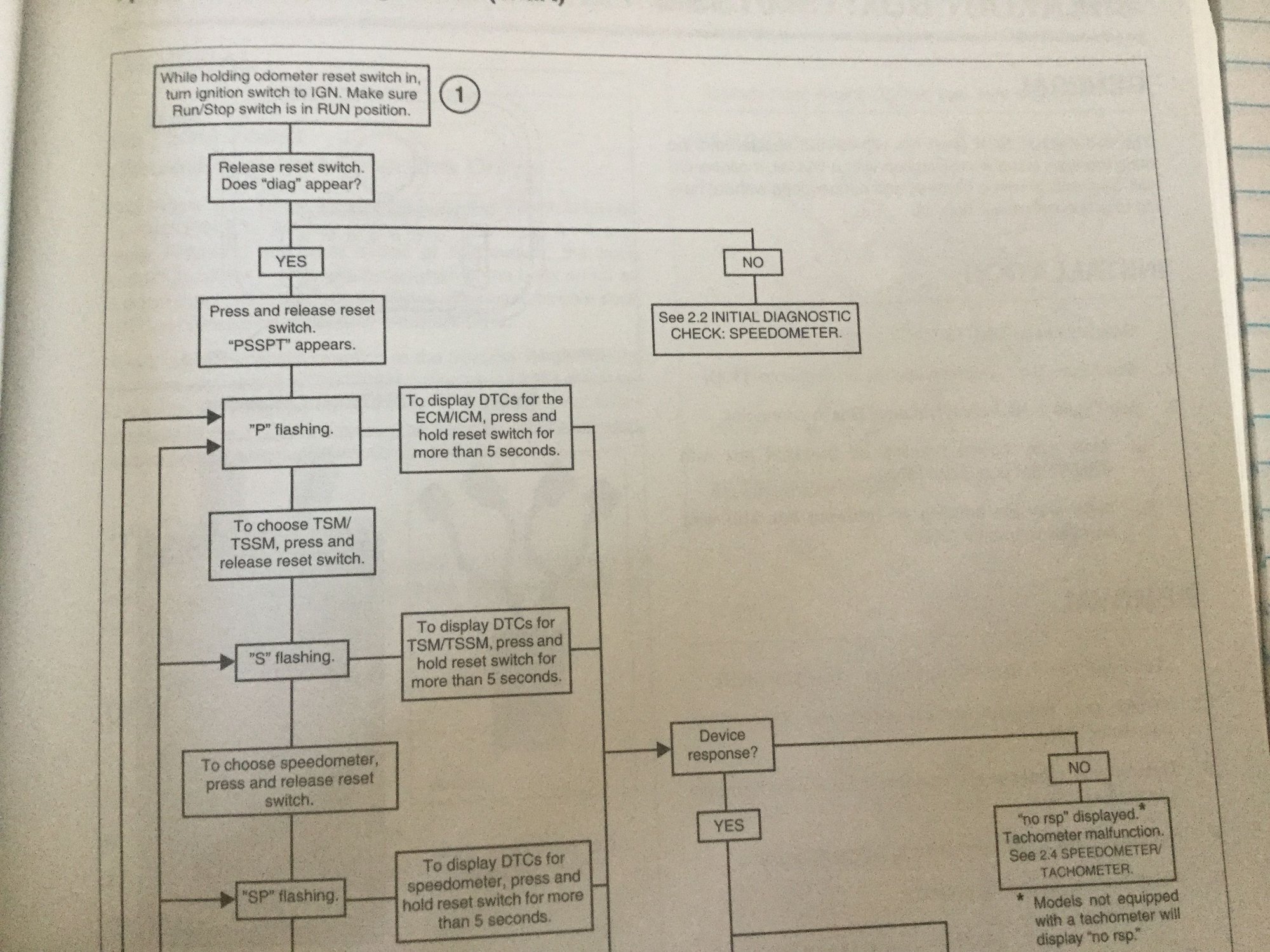

Glad it was an easy fix, let's hope it doesn't blow again. Here's a couple pages from the 2004 Electrical diagnostic manual. It explains how to pull the Diagnostic Trouble Codes on the bike. They help you pinpoint a problem. This link lists them too. https://www.fuelmotousa.com/p-29661-...es.html#pcodes
I would also check the connections on the horn make sure they are tight and clean and try the cigar lighter and see if it works. Those are two things that could cause excessive current through the fuse.

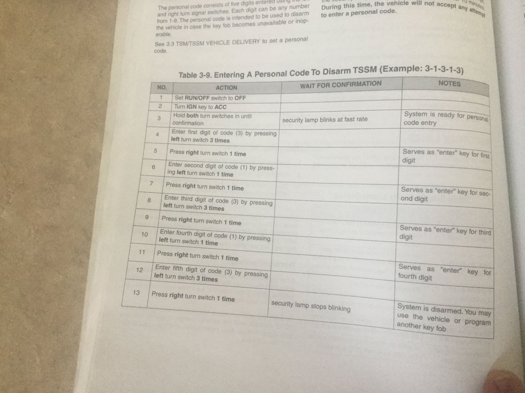

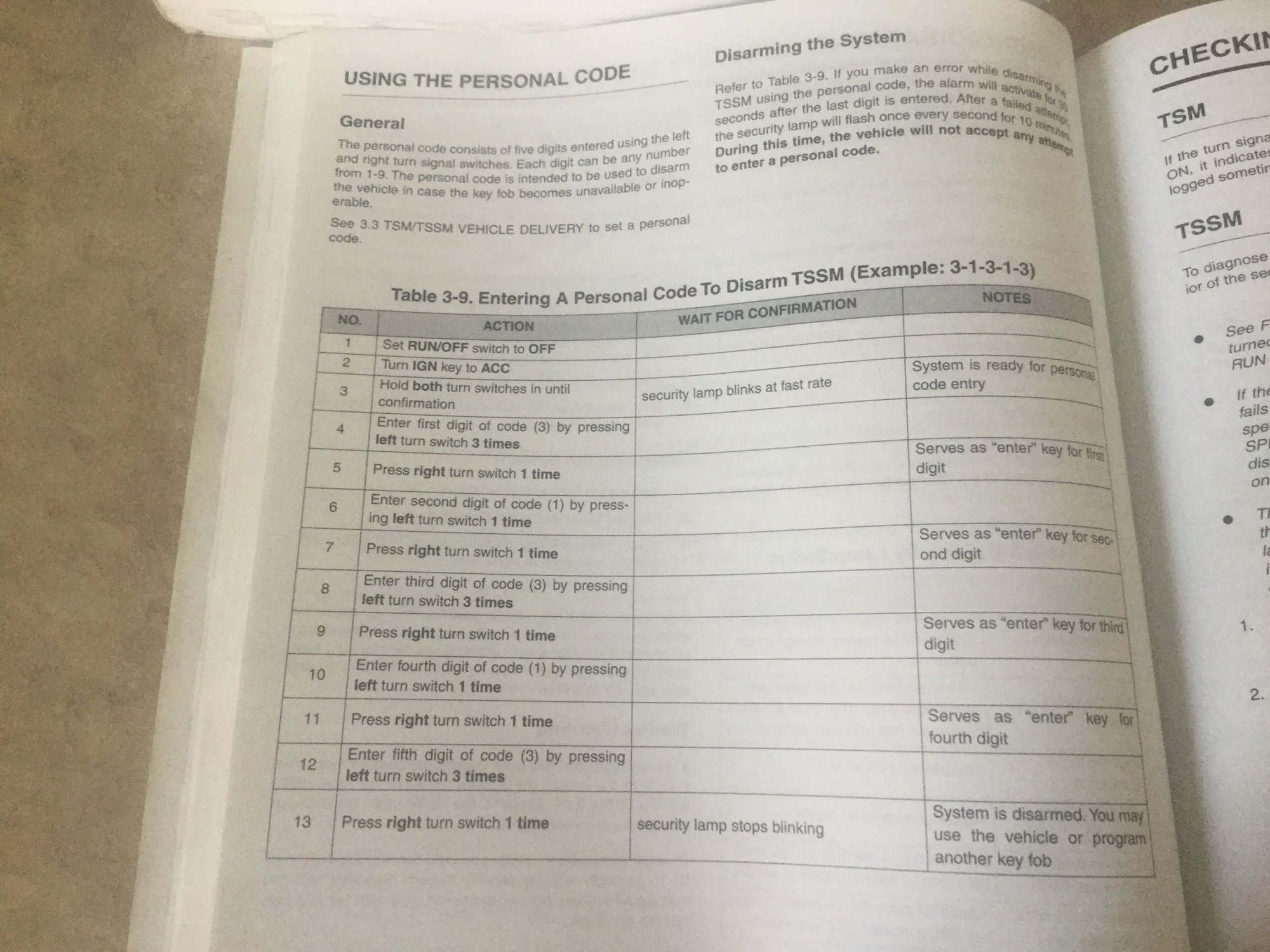

You mentioned having a fob. Do you know the PIN number? This may be in the owners manual:
