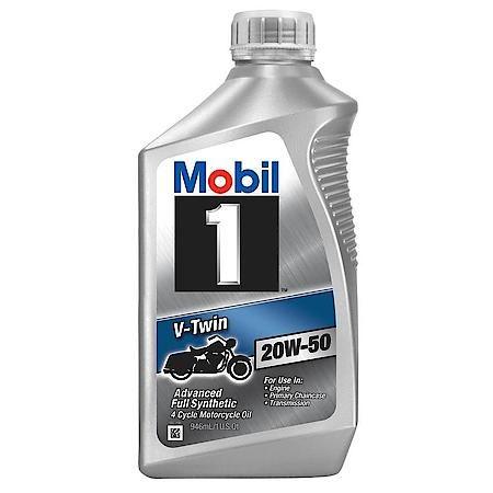

I've been reading here and searching for answers about why it's such a pain finding neutral. So, this morning I put the bike on the jack, drained the primary, adjusted the clutch, filled it with Mobil 1, and went for a putt.
I'll be damned, it worked! So far, it drops right in.
So, for all you guys that made this recommendation, I thank you.

Mobil 1 syn, what weight? or does it even matter?

20W50, I got it at O'Reilly's

I really like Mobil 1 in my motor, but use Redline Primary Case fluid in the primary. The key to easy neutral is not to over fill the primary....just enough for the oil to just touch the bottom of the clutch basket when bike is straight up (not on kick stand).

Mobil 1 20w50 V-Twin Syn works for me, too.
