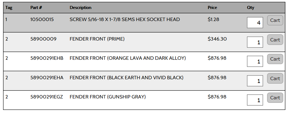

that's what i thought too, but the 2018 road glide custom and the 2018 cvo road glide custom both have the same part number for the fender (in prime). and the 2018 doesn't show any spacers. probably will want to get the lower springs in the forks though....

they also show a part number for the fender in prime, not just the cvo colors. I bought one for the wife's bike because they do sit a little lower (at least 2013 and below).

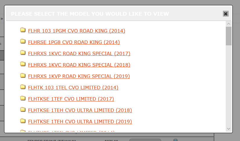

would like to know for 100% sure myself. here is the page from the parts manual showing the fender in the different colors and primed, and then a partial listing of what else that primed fender is used on.
will the fender work, or is this another typo on hd's part?
I cant speak to if it's a typo or not, I have never looked for anything CVO to be primed. I can say that every single 2014 and newer bike that we have put a 21 on has needed the fender raised. The only CVO bikes that have the taller fender are the 2018 and 2019 FLTRXSE as they are the only ones that come with a 21 on the front so a fender on a CVO street glide would be the same as a regular street glide. The Road Glide is the only one that is different.
