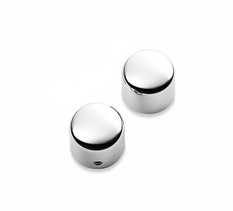

Originally Posted by foxtrapper
Are you sure you have that and not simply a set of chrome cap on each side? Look underneath, you may well see a small grub screw holding it in place.
If you really do have that Drag Specialties axle, I don't think that alone would cause a tweaking. Removing and installing the front wheel axle doesn't cause any forces that would tweak the forks.
I do have it. But I agree with you, I don't think it is the issue. I guess I just mentioned it as a completeness of info thing.

Originally Posted by oldhippie
Thanks, this is helpful as were all of the other responses. One of your comments reminded me, that I noticed a aftermarket axle assembly on front axle. It eliminates the big axle nut and just looks like a smooth chrome cover there. I'd never noticed that piece of bling on other bikes before, but since then I've noticed it on other bikes, apparently it's a Drag Specialties "upgrade". My indie was familiar with them and mentioned he didn't understand why people felt the need to dress that part of the bike up. Now I have to wonder if that might play into this.
Chrome cover only hides the nut.....he obviously doesn't understand how the front axle works.....now that I have read this part you need to find a guy that understands those axles. Not a drag part either.....if he reinstalled it in correctly...bingo that's your problem. I have stock axles if you need one.
