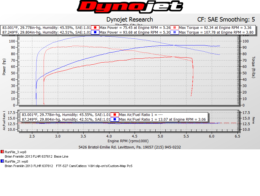

Old Jan 2, 2019 | 08:01 PM
brihvac's Avatar
brihvac
Joined: Jul 2007
Posts: 1,462
Likes: 22
From: Delaware
Cams and a tune
