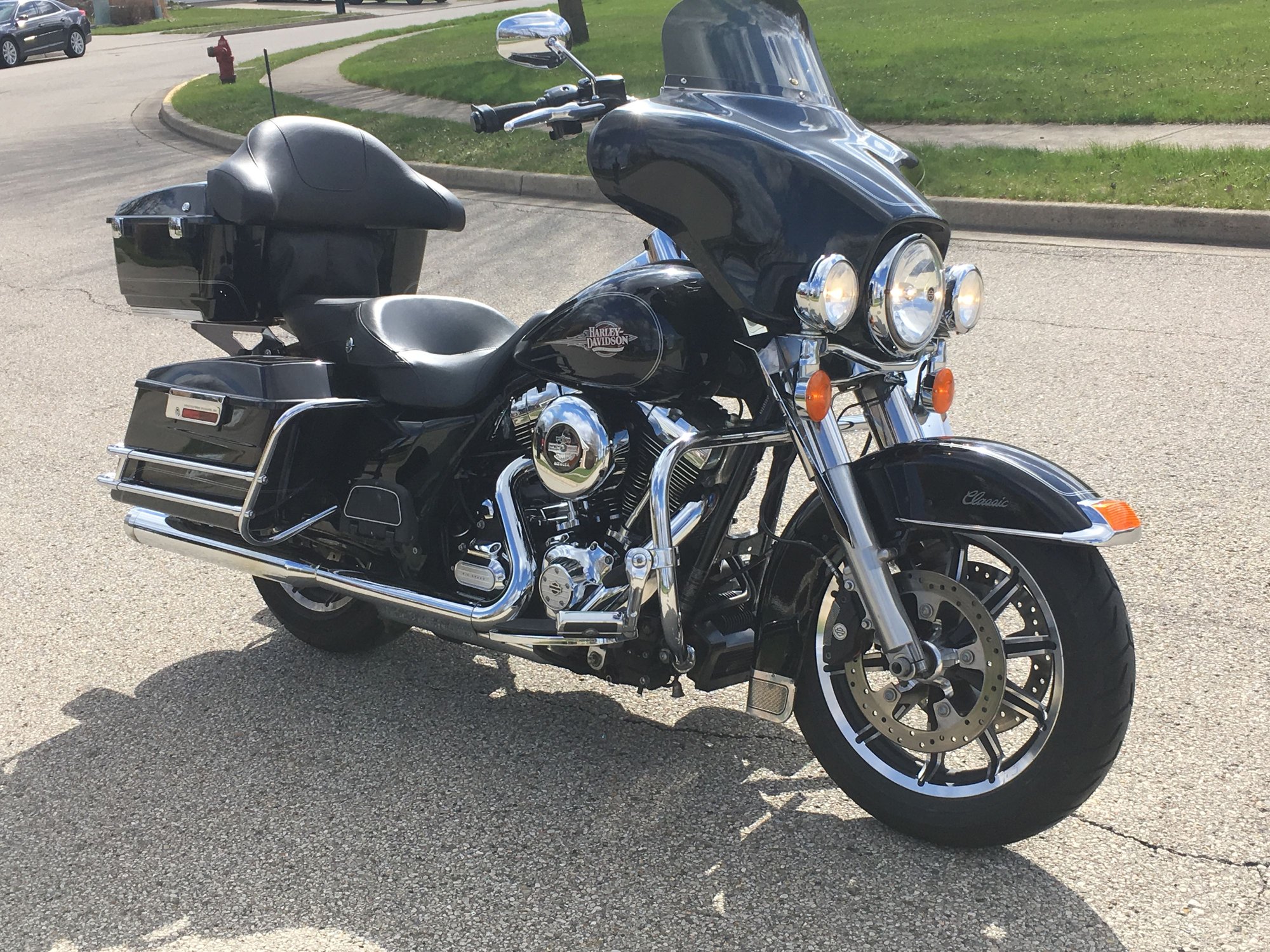

I'm getting ready to put new lifters in (sticking lifter slow to pump up), oil pump spring, and adjustable push rods. Now i'm debating if I want to go ahead and do cams while i'm in there. If I do, I'm wanting to use 551 cams which would be about another $300, then there is inner cam bearings, bearing tool, cost of tuning, plus the tuning license, (or whatever you call it) by the time i'm done it adds up to a pretty decent amount of extra money to go from just lifters to adding cams. With the luck i've been having lately working on my bikes I may just pay to have this done, which adds a few hundred more.
I have 3 bikes but this one (12egc) is my main ride and I also do trips on it. I ride it about 10k a year. almost always ridden solo.
I'm running a de-catted head pipe with stock mufflers (I do also have a set of slip-ons if I need them) , outlaw AC, and xeids (think I spelled that right)
I don't really feel that it is lacking for power much, but that extra paw-pow, sure would be fun at take off.
price would vary between $300 for lifters, pr's, and oil pump spring doing it myself, upto $1600 to have that stuff plus cams, licensed, and tuned.installed by someone else.
i know only I can decide if it is worth it to me, just looking for feedback from those of you that have done it.
FYI I have done a cam change and big bore kit on a 1999 rk, although it was many years ago.
I know I would love it once it was done, just not sure if it is worth that much more money to do it. (my pokets arent very deep at the moment) but if i'm going to do it, now would be the time.
