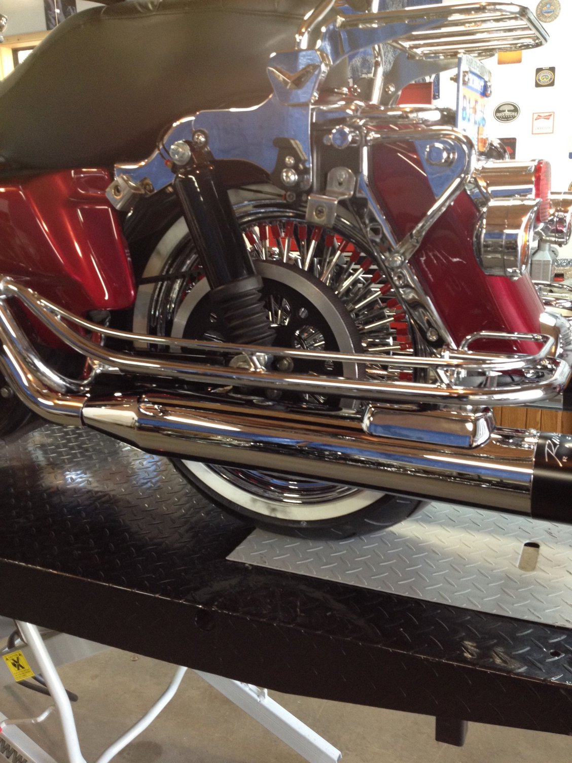

Not great pics of the lift, but you get the idea.

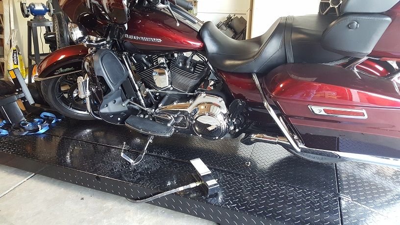

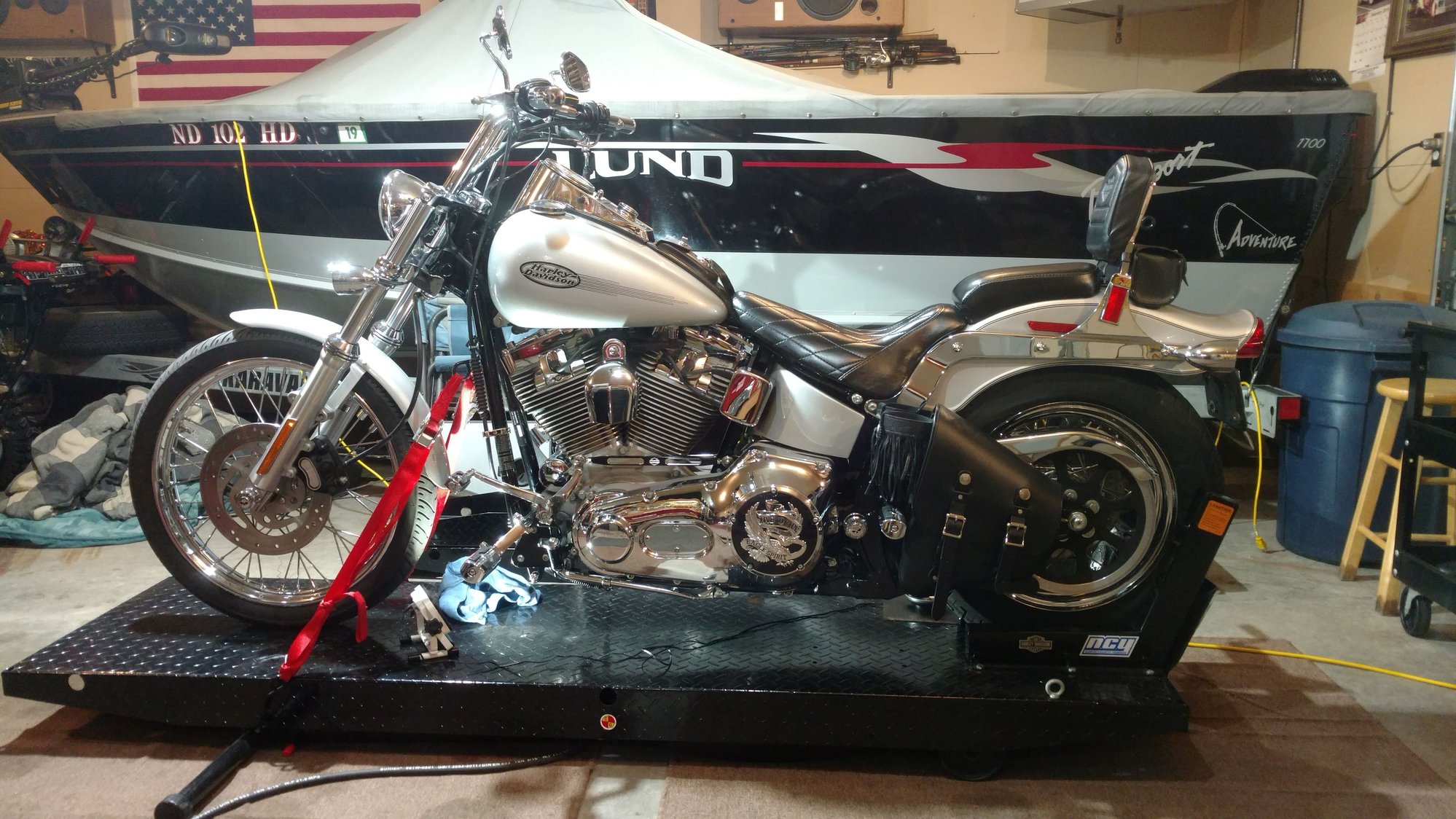

I have the direct lift with the side extensions also, you mentioned moving it around in the upright position? mine came with a two wheeled dolly for moving it around the shop and it works great! didn't yours come with one I am pretty sure it was supposed to? I don't currently have a photo of it but I can take one if you want to see what it looks like
with extensions
without extensions
