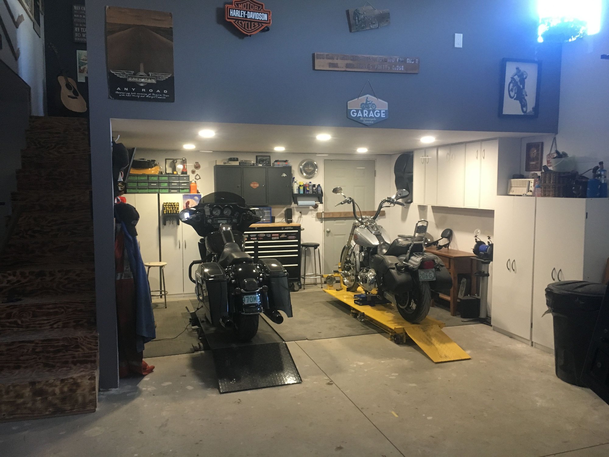

I put carpet on my extension as is on the floor (after this picture), keeps tool from rolling as easy and parts don't scratch. The early pic with the front extension looks like it kind of makes the drop panel useless.
I do leave the extensions on, most of the time. Coolest I've seen is a couple of guys who have their slab recessed for the lift - don't need the ramp and when it's not in use being flush with the rest of the floor is great.
