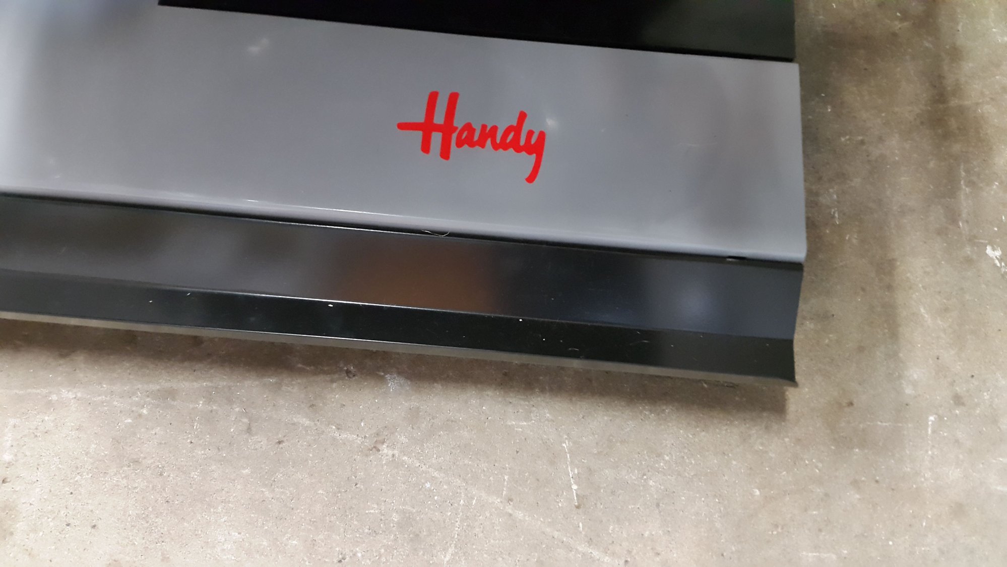

My Handy Lift is 29 1/2" wide for the lift table and it has two add on wings that make it 39 3/4". I don't have any trouble riding up onto or off of the table without the wings and didn't install them initially because I have a small garage. My floor isn't completely level so every tool I put on the lift table rolled off. I installed the wings and now I have a nice place for the tools I'm using on both sides.
One other thing I'd like note. I have a standard wheel vice on my lift that has a crank and I work alone 99% of the time. The key to putting a bike on the lift by yourself is to measure the front tire width and open the vise to just that or a little smaller (now I just know how far apart to have them). Ride the bike up until the front wheel is all the way forward in the vise, kill it in gear and step off to the left holding the left handlebar. Crank the wheel vise tight and then attach the tie downs you already had laying on the deck. Reverse the process to remove.
