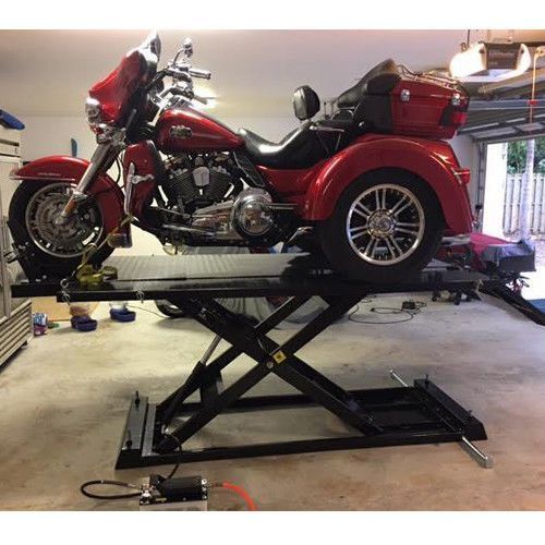

The HMC is designed exactly for what you are talking about with the two piece side extensions. Makes them easier to work on so you're not bending over the part of the extension that you aren't using.
Also, The condor will bolt right up. The HMC lift is predrilled for condor chock or for a cycle vise. I use the condor my on mine and you can still do front end service no problem. I have the 24x82 lift, but the bigger 60x90 uses the two piece side extensions.
Attachment 619141
Attachment 619142
