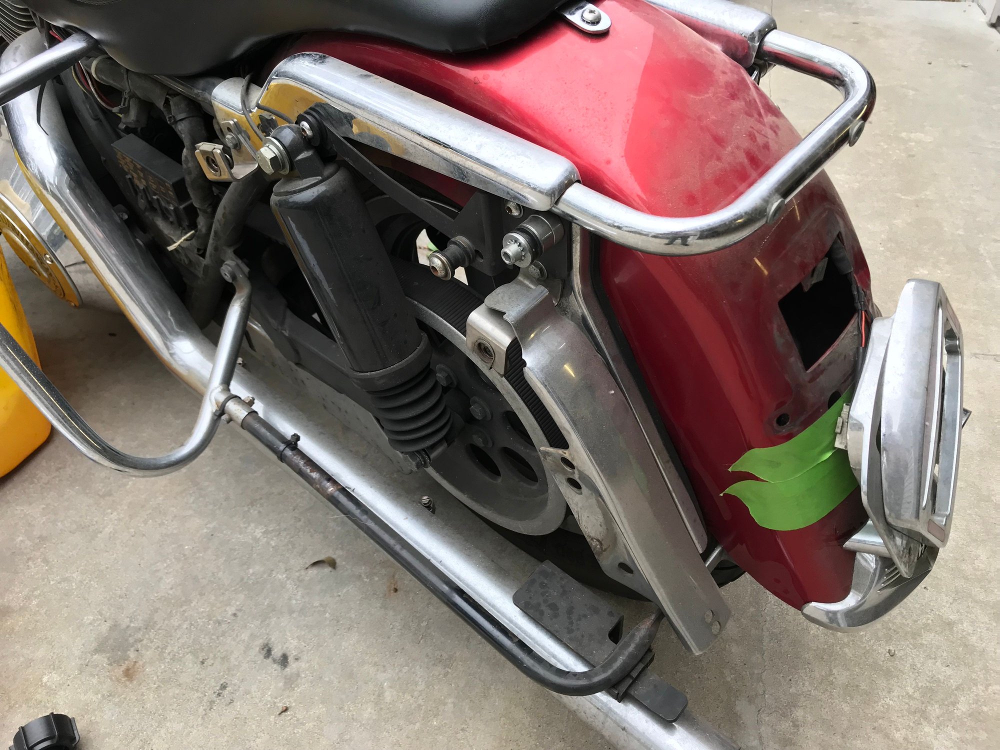

I played around with the exhuast heat shielding. It had some hose clamps around the shields, unfortunately the tabs were broken off, so they can't be held on normally. I went through an assortment of stainless hose clamps, trying to find some that I could orient so you couldn't see the "ugly" part of the clamp.
Also messed with some bracket alignment in the back, trying to use different hardware to make it look better, and make the saddlebags easier to put on. This bike was in some sort of fender bender in the back, so a new rear fender will be needed at some point. I also started polishing the chrome, oh boy. Luckily its in pretty good shape for the most part, just very dirty and corroded.
