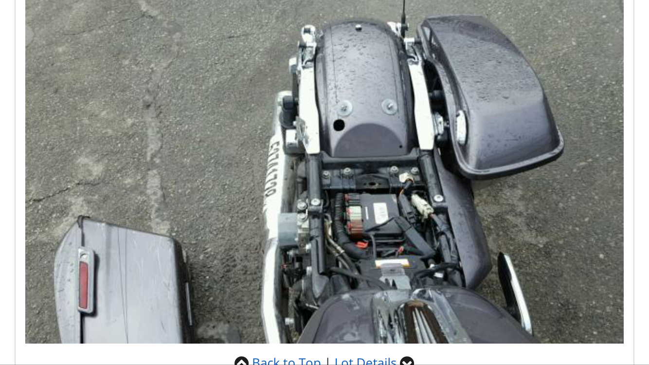

Old Feb 1, 2019 | 08:58 AM
KonradL's Avatar
KonradL
Joined: Feb 2016
Posts: 83
Likes: 6
From: Central CT
