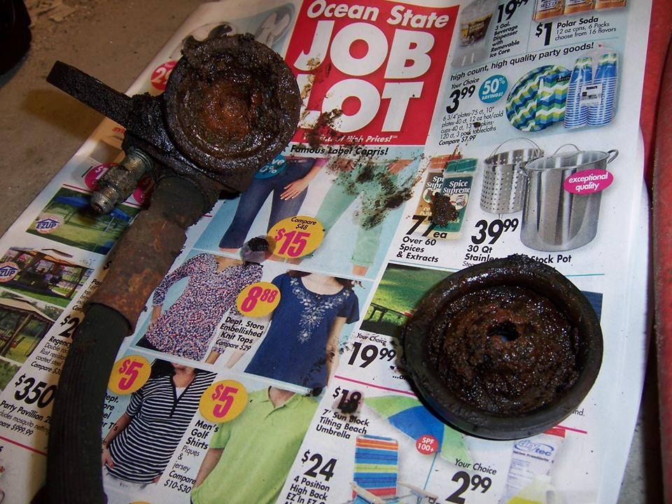

I never used to change the brake fluid on my regular cars or bikes, but on my classics, it's a must do.
This is what the front wheel cylinder looked like on my 64 impala after 20 years of not changing the fluid.
The other side wasn't much better.
Good pic.... that's why I think it's a must do on all cars....... Since there are relatively few catastrophic failures, people are unaware of the damage caused from not changing brake fluid, and the degrading effectiveness of their brakes happens slowly, so most unaware their brakes have lost a step. They don't believe changing fluid is necessary.
I remember, as a young guy (8-15yrs old) helping my Dad and our neighbor change drum brakes in the older cars. My Dad & neighbor were both car guys that fixed their own cars, and helped neighbors fix their cars too.
Just about every brake job they did, at least one of the the brake cylinder seals needed to be changed. And every time we opened a brake cylinder, there was always a layer of rust and occasional pitting. We had a honing tool that we used to hone the inside of the brake cylinders... In retrospect, I'm sure the brake cylinders would have been in better shape if people had changed out their brake fluid back then... but nobody did... at least not until they need several brake cylinders repaired, and then the fluid was pretty much flushed as part of the repair...
I have to wonder how many ABS modules/calipers/brake lines, across all types/makes/models of vehicles, are replaced out of warranty... and how many may not have needed replacement if the brake fluid was changed on some kind of regular schedule...?
I still have a set of hones that I used many times rebuilding wheel cylinders and clutch slave cylinders. You could buy the rebuild kit for 3 or 4 bucks. I have rebuilt sets that looked every bit as bad as those.
In those days, even if they leaked, you could reach down and pull the emergency brake to stop - with our bikes if you have ABS module failure, you aint got chit!
