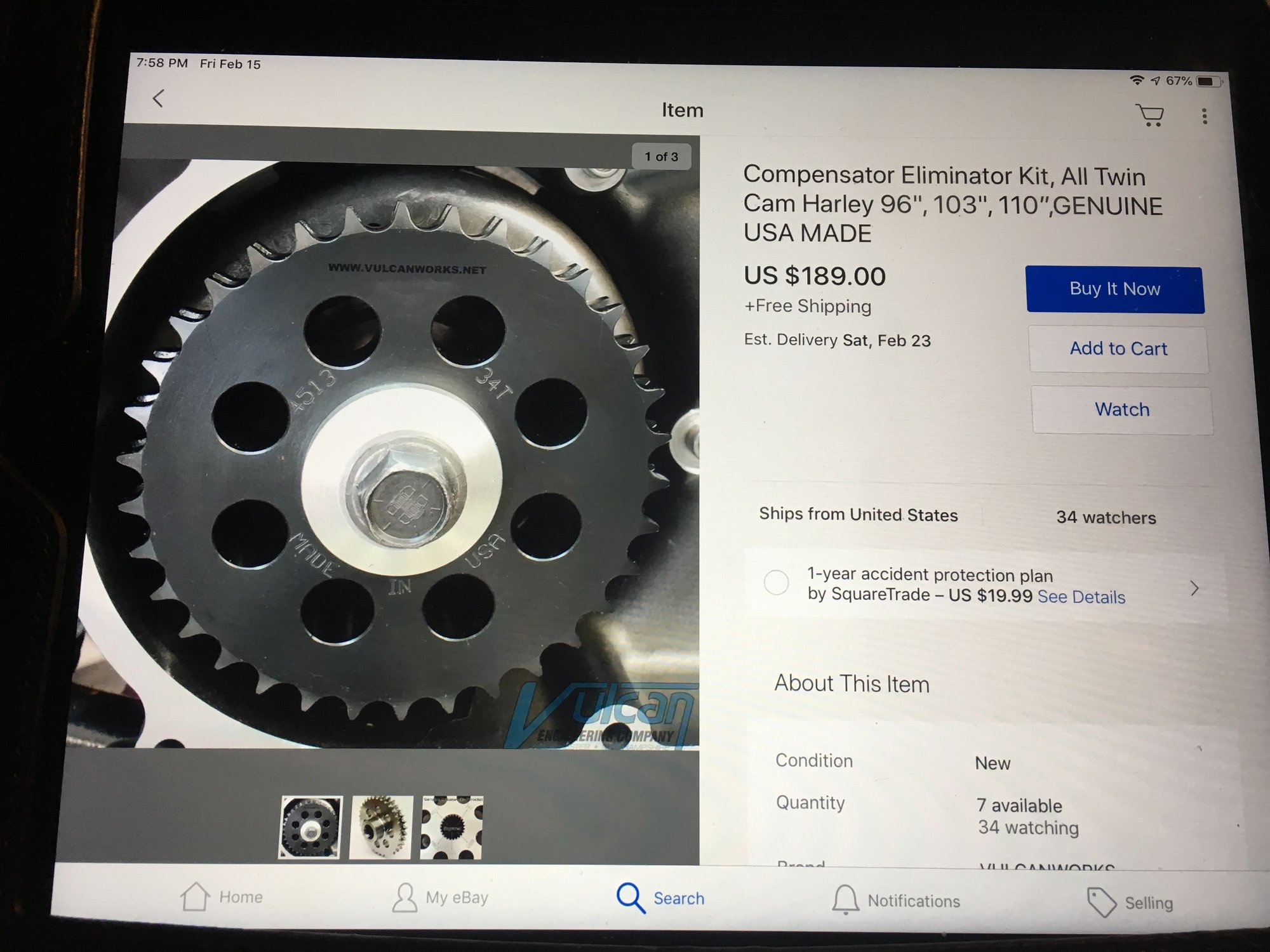

Has anyone installed this and what where the results?
I have a 110 engine.

On a stock pressed crank=twisted crank.

I have a Iron Horse Crank!

My tech guy says it wont hurt anything. Compensator is for slow speed curse. Sportsters have solid gears, no compensator

This was discussed on the other Harley forum, general consensus is go for it.
Guys have thousands of miles with no issues with run out.
Go to Harley tech talk and read up .
