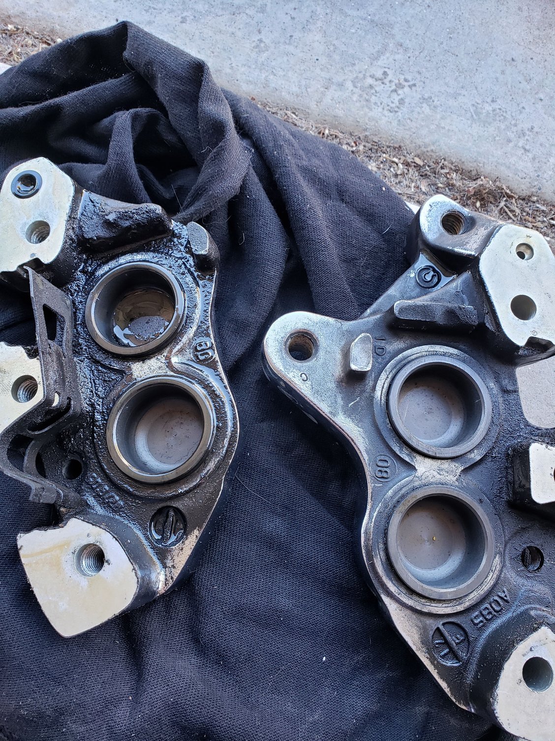

Old thread but was wondering this myself. Front right caliper is leaking all over. Anyone tried this Cycle Craft kit?

year or few ago I was told by multiple sources they are not rebuildable, need to buy new.
Link to kit?

https://www.denniskirk.com/cycle-cra...rd/1913974.sku
With pistons:
https://www.denniskirk.com/cycle-cra...rd/1913975.sku

I spoke with Cycle Craft earlier this year, and they claimed that the kits were DOT 5 compatible. Good to know,

Well gonna order the kit for $17 for seals only. Not buying a new caliper for $900 & eBay has used for like $50 but who knows what shape they're in. Worth a shot...

Well just installed the seals on the right side & bled right & left calipers. Feels nice n tight, will take for a test spin in a bit. Was definitely leaking around the pistons on inside of right caliper.
