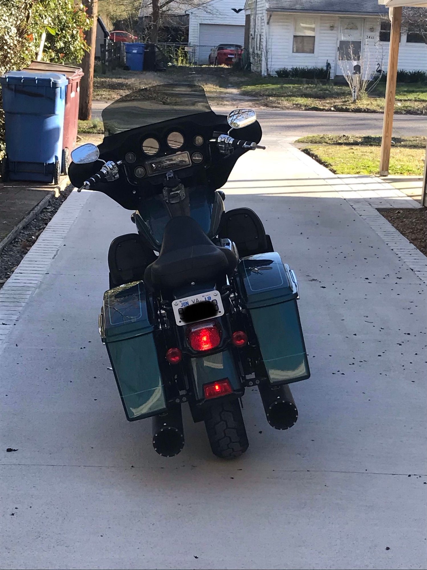

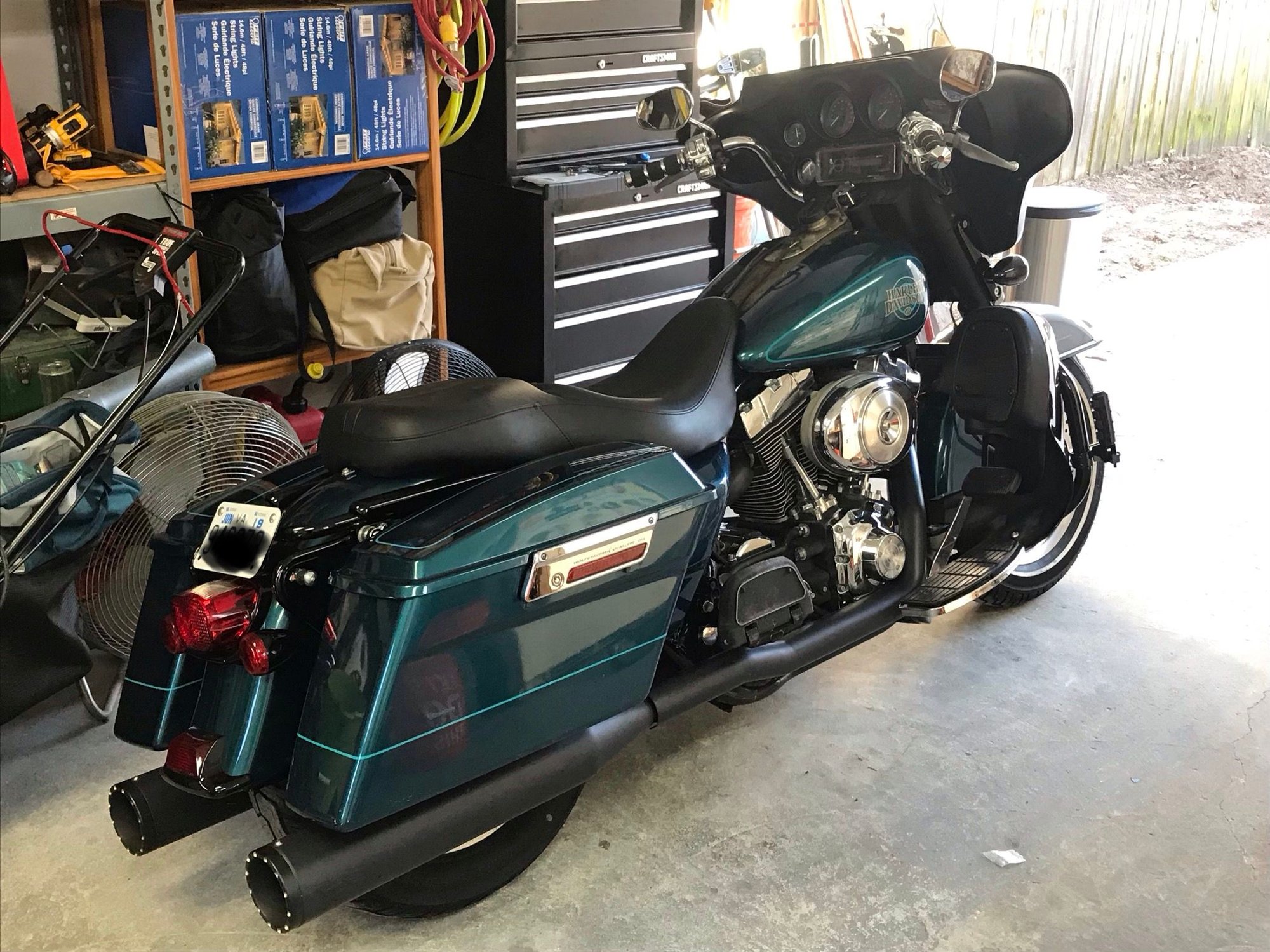

And just a couple of pics for motivation. Proof that it can be done!. And never mind the missing tank console. I'm picking that up from the powder coater today!
