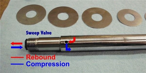

Some Ohlins shocks have compression & rebound on a adjuster called a sweep valve. This does both with one **** located at the bottom of the shock. This feature is available in 2 different models through me. One is a #3-#3 which starts out as a HD-159 or HD-774 before re-valving for you if necessary. It has 77mm of stroke and is a separated (internal reservoir) shock & is height adjustable. The second one is a #2Adjustable that starts off before re-valving as a HD-136. It is an emulsified (no internal reservoir) shock & is not height adjustable as it is 13 1/4" long so height adjustable is not needed. The stroke is 93mm long. If you plan on just cruising than an emulsified will work without any sort of shock fade or failure. If you plan or actively riding the bike under race type conditions than you will need a separated system to avoid shock fade and shock failure.

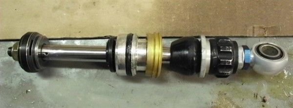

Default Öhlins Compression & Rebound Adjuster Explained
Öhlins Compression & Rebound Adjuster Explained:
This is a typical compression/rebound adjustable assembly used in many models AKA single adjustable (single ****). Notice the black needle valve seat next to the needle valve just under the shaft.
Compression Stroke:
When the piston goes up (shortening) the piston is pushed into the oil and is forced through the piston circuits and push against the steel shims that act/mimic like a spring. The bottom of the shaft has a needle valve & seat. The needle valve seat is (in this case) an open bleed. On the compression stroke the oil can enter this hole and the needle valve restricts how much oil can bypass the compression shim pack thus making the shock less resistant to change (weaker resistance) and the amount is controlled how open the needle valve is. The oil flows past the needle valve than up & out the hole located above the main piston.
Rebound Stroke:
The opposite happens when the shock is pulled apart. The oil is sucked through the hole on top and flows around the needle valve and out the open bleed needle valve seat to replace the oil at the top of shock.
