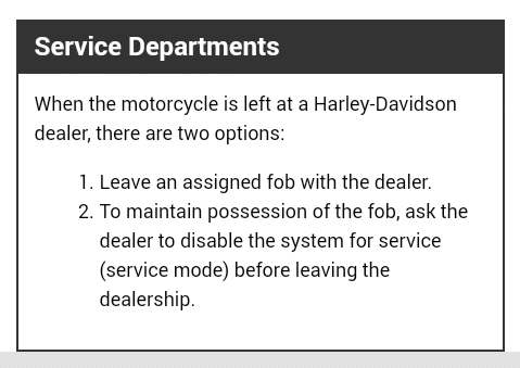

Perhaps your dealer left it in service mode?
Originally Posted by btsom
READ YOUR OWNER'S MANUAL. It will cover the maintenance mode, transport mode and other options that YOU can turn on or off. And learn how to enter and use a PIN before a dead fob battery leaves you dead in the toolies. Nothing like a $200 tow back to civilization to motivate you to what you should have already done.
The OP's Owners Manual (nor mine) does not cover entering, or exiting the service mode.
