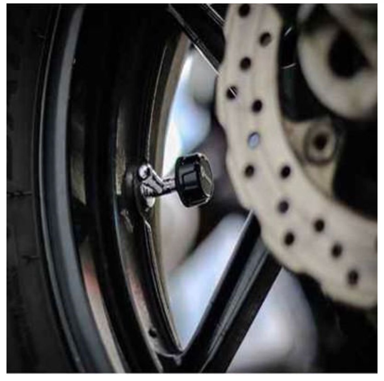

The FOBO 2 does look smaller but the centrifugal force will probably still make the rubber stems bend and blow out eventually. I wouldn’t trust it. I bought the t stems but haven’t installed them on the new bike yet.
i am confused about the T stems. One type needs to be installed by a tire installer and the other is screw on? Is one better than the other?

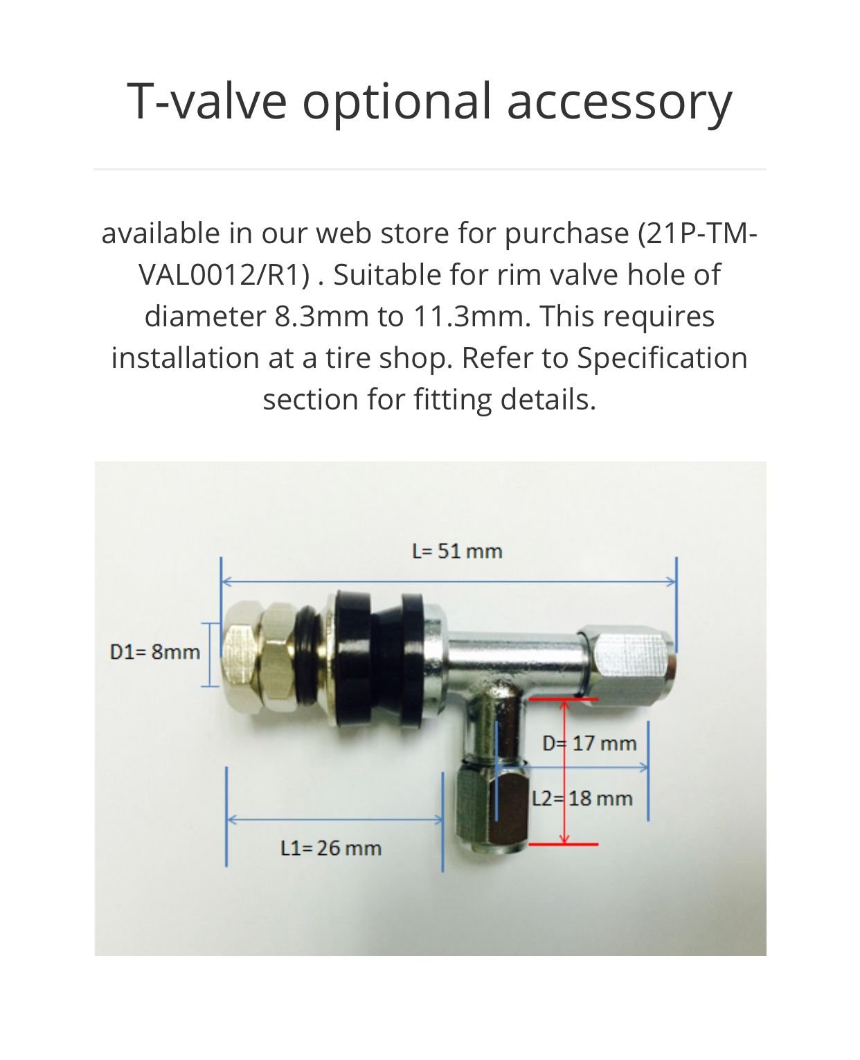

They're talking about replacing your valve stems, before you screw the FOBO sensors on. FOBO also recommends their sensors be used with metal valve stems to avoid the possibility of what azgrumbles has experienced and is talking about. "T-Stems" are a type of Valve Stem that has a place to screw the sensor on, and still be able to add air to the tire without having to remove the sensor... check FOBO's site out, they sell them too. If you go with a screw on sensor it is best to change your valve stems to metal valve stems before screwing the sensors on... If you're putting on metal valve stems, T-Stems (T-Valve Stems) are handy to use.

The T Stems, while not required for the FOBO system, do make adding air to the tires more convenient:
You don't have to remove the sensor from the valve stem, which isn't terribly time consuming but it's extra steps.
And the side benefit of the t-stems is that the 90 degree tee is easier to hit with the air chuck that I have.

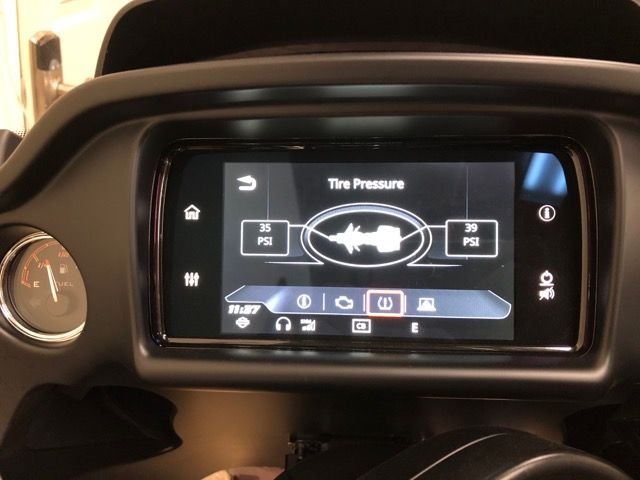

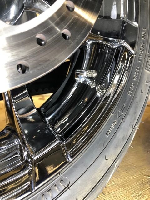

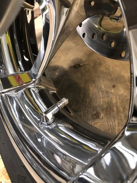

My parts guy also said it couldn't be done because the CVO's have something else that regular bikes don't have. My tech checked into it and said it could be done without anything other than the CVO TPMS sensors and a flash to the BCM to enable the display through the Infotainment system. The sensors communicate with the BCM through the security system antenna, not through some magical thing that's exclusive to the CVO's. The only limitation might be how well the sensors fit your rims. I added the HD Agitator rims at the same time to my 2019 RGU so there was minimal extra labour to mount and flash. The sensors physically fit, but because the stem hole is not centered on the circumference of the wheel the valve stems angle down a bit more than they would on a wheel that has the hole in the center. The stems are already on an angle, so the angle is even greater. My front stem was actually mounted so that I fill it from the left side of the bike. A bit of a compromise to make everything work. I had mine installed by Paul at Clare's HD in Niagara On The Lake, Ontario.
A few photos are attached. As you can see in the radio, I need to add air to both tires since it's now dropped to the mid 30's with rain. No riding today.
