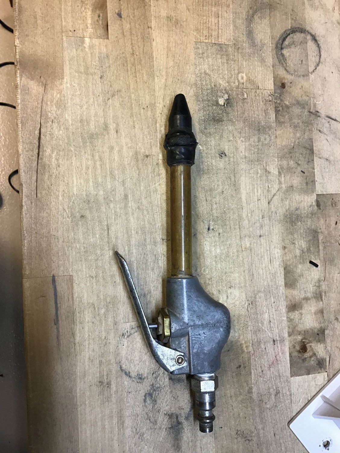

Remove the valve core and use one of these. You get maximum air flow that way. Bouncing the tire a few times on the floor helps also.
