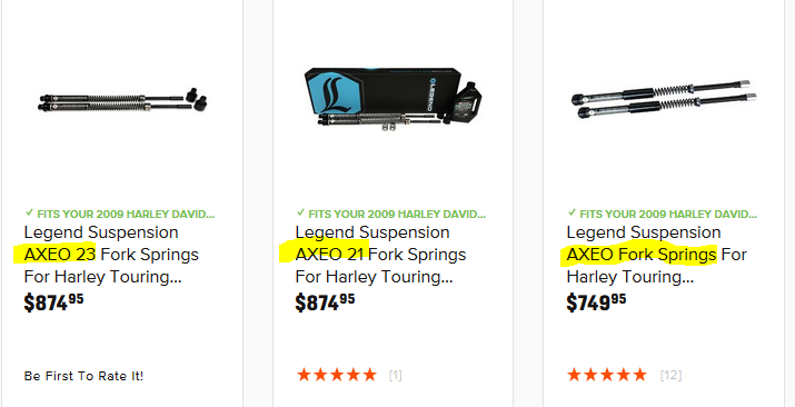

Originally Posted by dajogejr
FYI guys,
$875 may be full on retail direct, but I've found 6 places online within seconds that sell them for $749 shipped free.
There are three kits
> 23" kit
> 21" kit
> Standard / Lowered version
The big wheel kits sell for $875. You won't find those any lower. The $749 price you mention is for the standard / lowered kit
