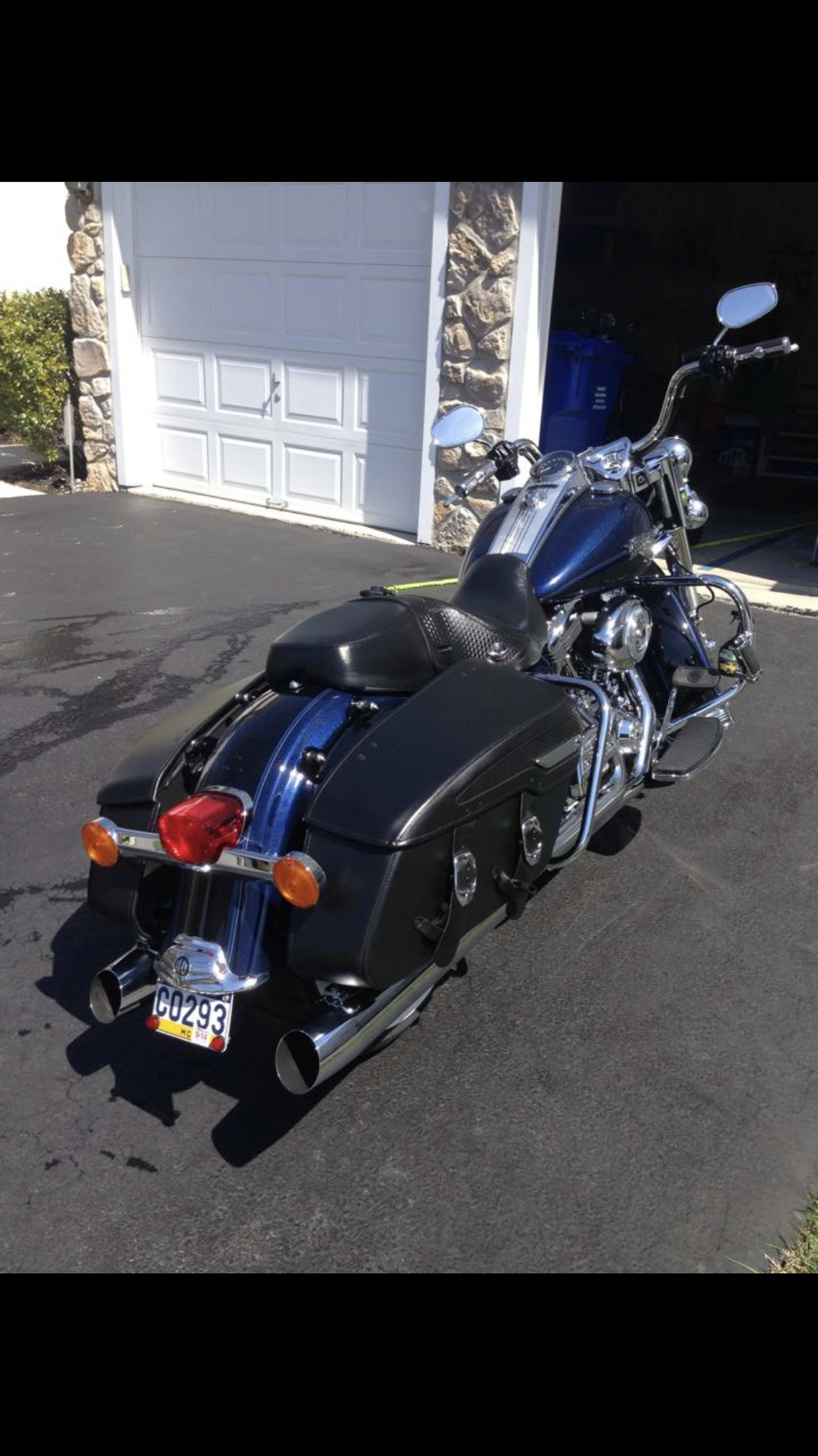

On my 09 Classic I used the light bar from an 09 Road King Standard or 09 Electra Glide Standard.
Directional Bar 68742-09
Light Assy 69378-09
Plate Bracket 69380-09BHP
Bumper 60909-09

Yes.The light bar is 1.5 inches narrower than the original on your bike.The light assembly is LED,which I wired into the tail light.The bumper is a little rubber bumper that goes between the bottom of the bracket and the fender,it just barely touches the chrome surround of your fender tip light.
