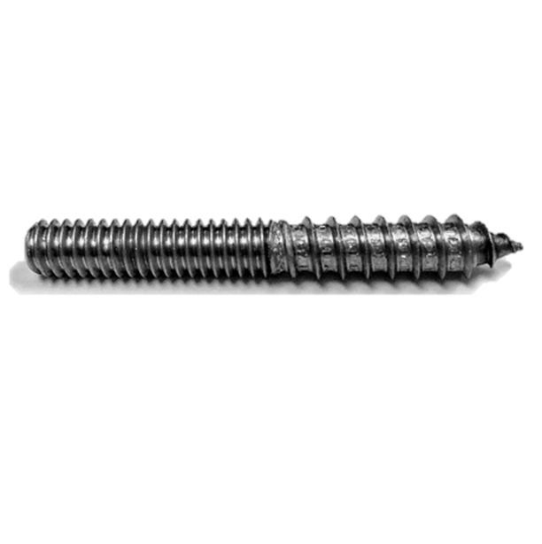

The cheap Ebay racks look and work fine. Once on, nobody will know what kind of rack you have. One issue to note with the Ebay Tour Paks is that the center of the rack may be appreciably different from the mid-point distance between the mounting screws. If you measure your mount points by the screws, the Tour Pak may be visibly eccentric. Mount the rack by appearance, not measurement. Liberally put masking tape where the holes are likely to be, or could possibly be drilled. Jack the bike up so it's not leaning, and position the rack. Check your test position from all angles. When you're absolutely convinced the rack looks centered, mark the masking tape with post outlines.
Once you've marked the circles on your masking tape for the posts, lift the rack off the bike, and put steel hanger bolts in the mounting threads, with the pointy end sticking down (1). The hanger bolts should be small and loose enough that they slide in and out of the mounting hole without threading, though not so loose they don't remain centered. Invert the rack with the hanger bolts in, and place on the masking tape. When you're confident you have the rack where you want it, give a little pressure to the rack, and the hanger bolts will make nice little pilot marks in the masking tape. Drill into that pilot hole first with a very small bit to go all the way through the plastic, then expand the hole to the desired size with a larger bit.
Use thin nylon washers, possibly called spacers at your hardware store, between the rack and the tour pak lid.
(1) You could also cut the heads off four thin wood screws, but this method is easier.
Steel Hanger Bolt

Many thanks for the write up, being in the machine shop world for a few decades, I have several sets of Transfer Screws, they do the same thing
