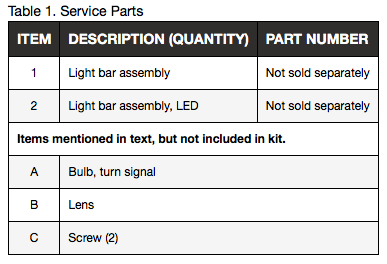

This is from the wiring diagram for your bike. You can see there is a Facia/Converter Module that is in the circuit to the light bar. Don't ask me how you troubleshoot to see if there is or is not power coming from the module. That's way above my paygrade. Maybe the Touring Electrical Diagnostic Manual has that information. Unfortunately, I don't have that manual.

Nice engineering HD. Broken license plate light and replace the entire tri- bar assembly.
