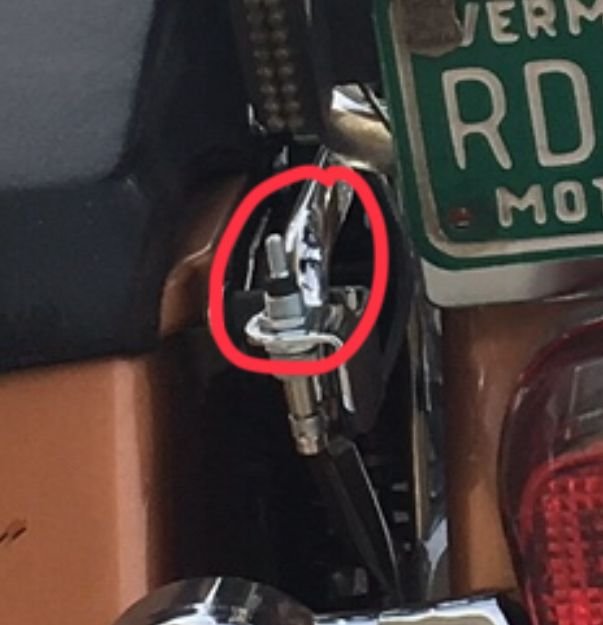

The larger connector would screw onto the existing antenna base instead of a mast (the one you posted I believe) and the smaller one would plug into the antenna connector in the pak. At least that is how the HD setup works when making a tour pak detachable.

Along with the extension, I think you might need 76219-00 which is the antenna cable adapter that allows the large end which I posted to be screwed onto where the mast was. The below pic is a shot of that adapter installed prior to me moving the entire antenna down to the fender and using a shorty.

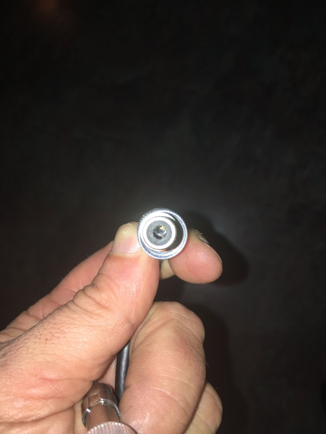

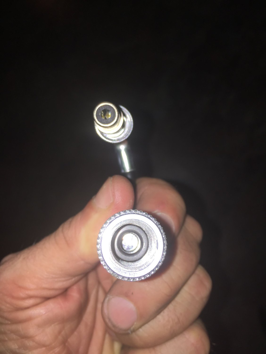

Just got back from Gail's. The parts guy sold me a cable that has the antenna connector on 1 end and a Farka connector on the other end. It's #69200295 cable extension, AM/FM antenna. See pix. Its exactly opposite of what I'm looking for I need the cable /antenna end to be female and the Farka end to be male that snaps into the Farka with the push button on it. So the hunt continues.
Dawg, what you showed might work but I'd like to have a smaller setup to fit under the seat. Thanks for your help. Saturday I'll hit Electronics supply and see what they come up with.
