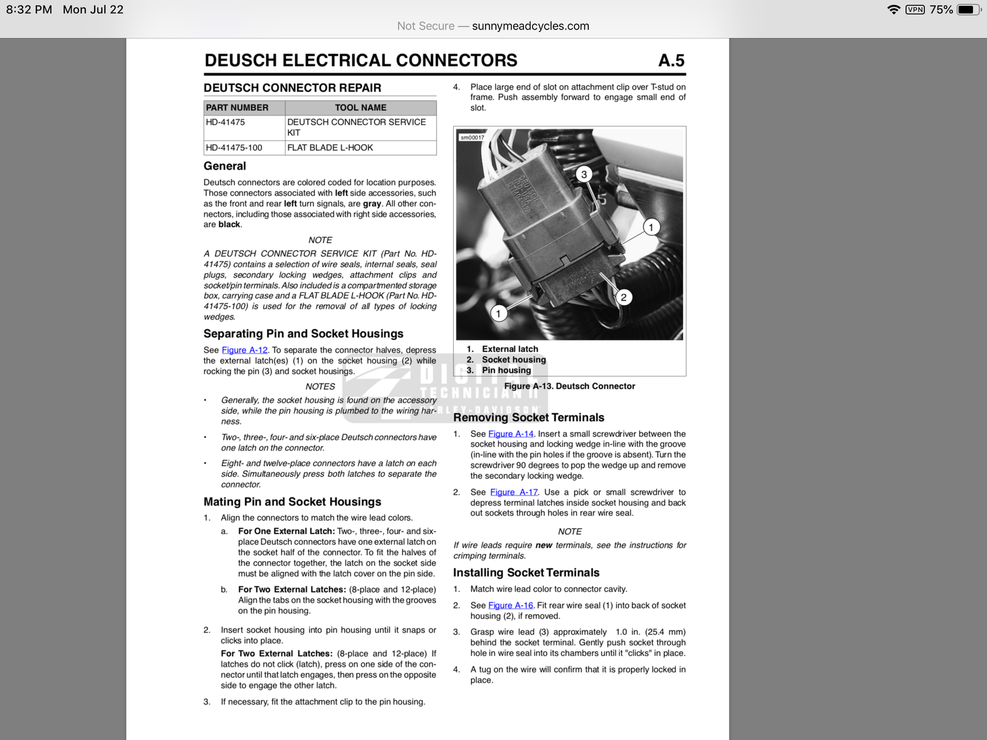

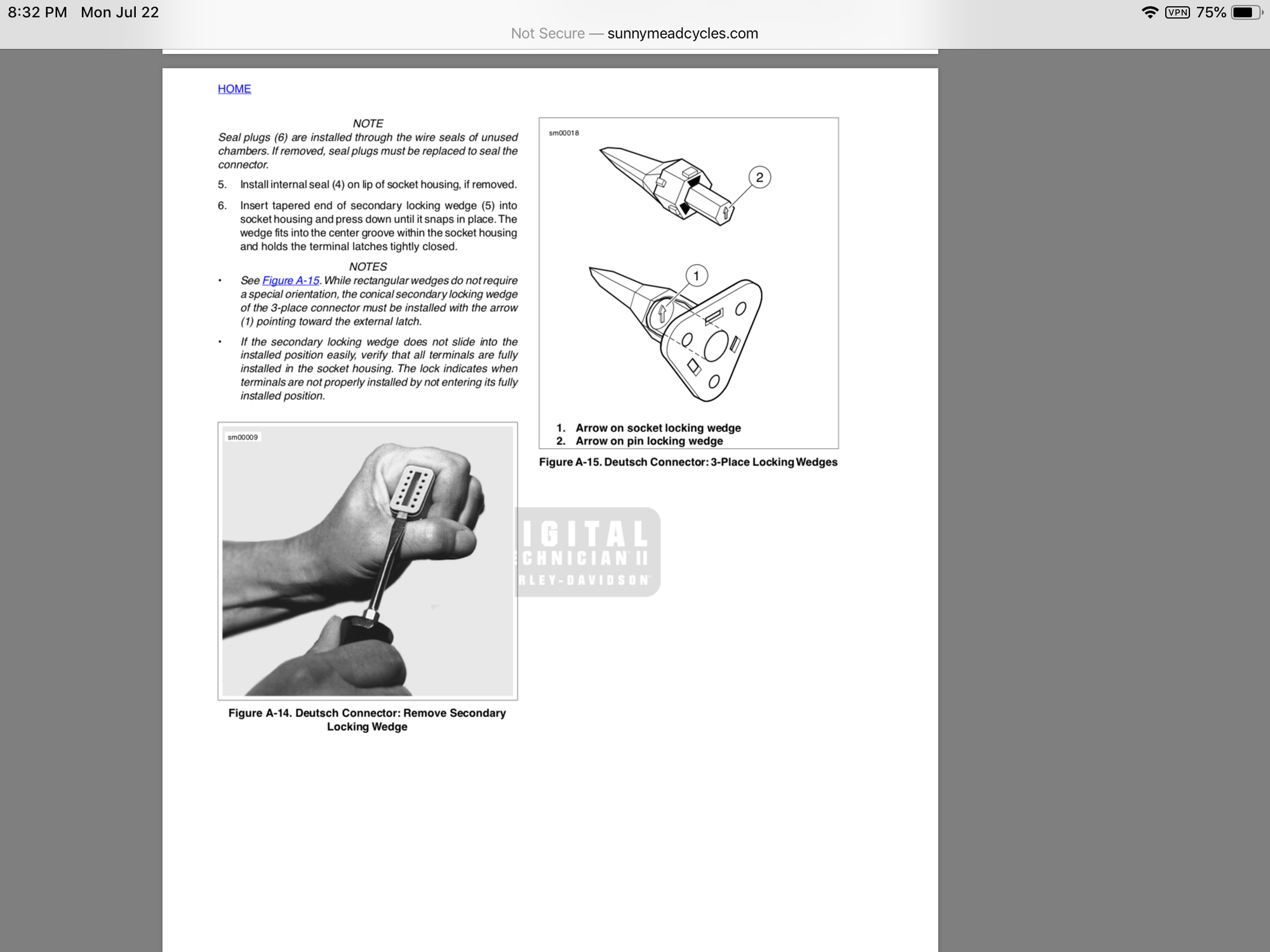

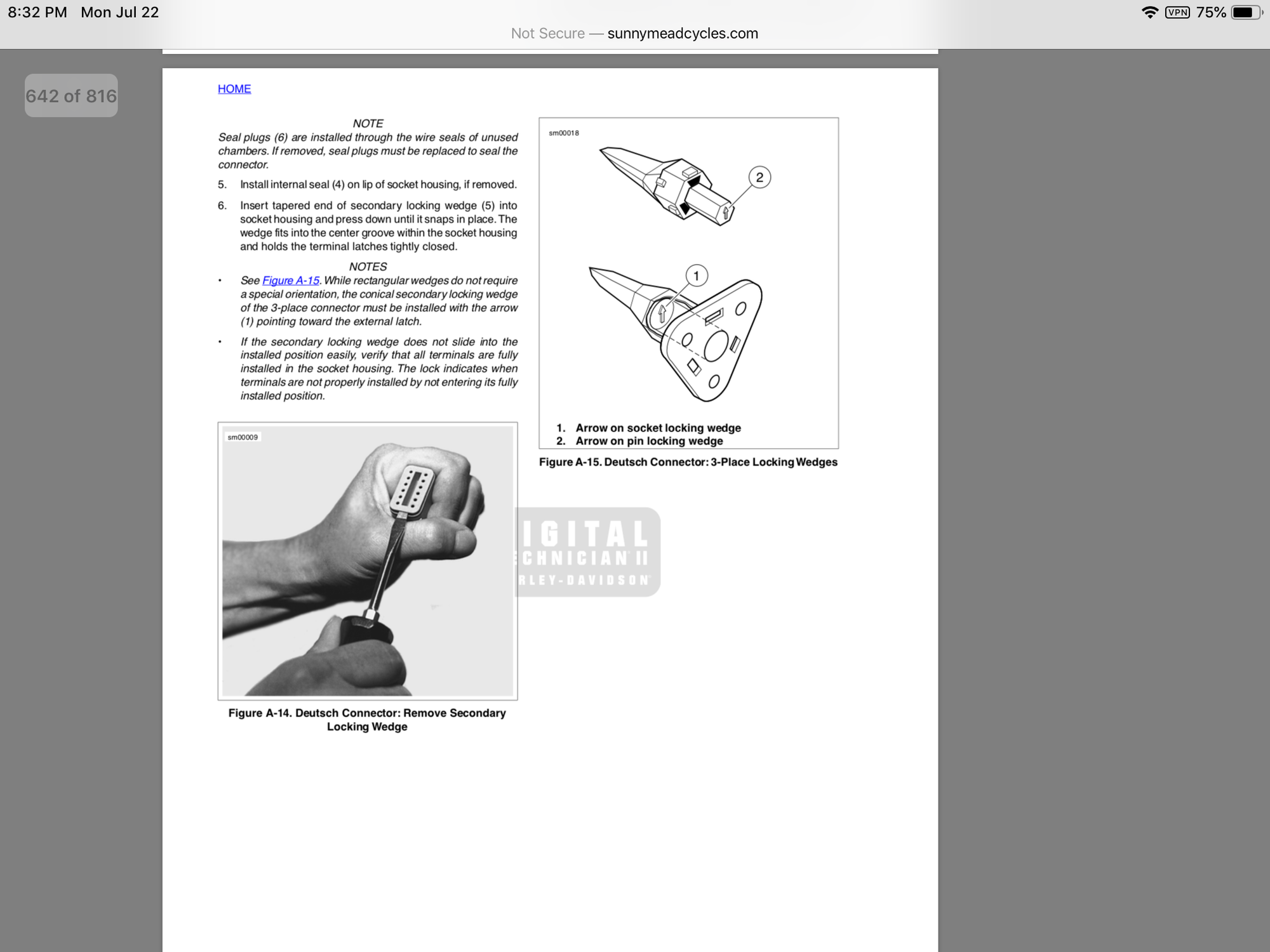

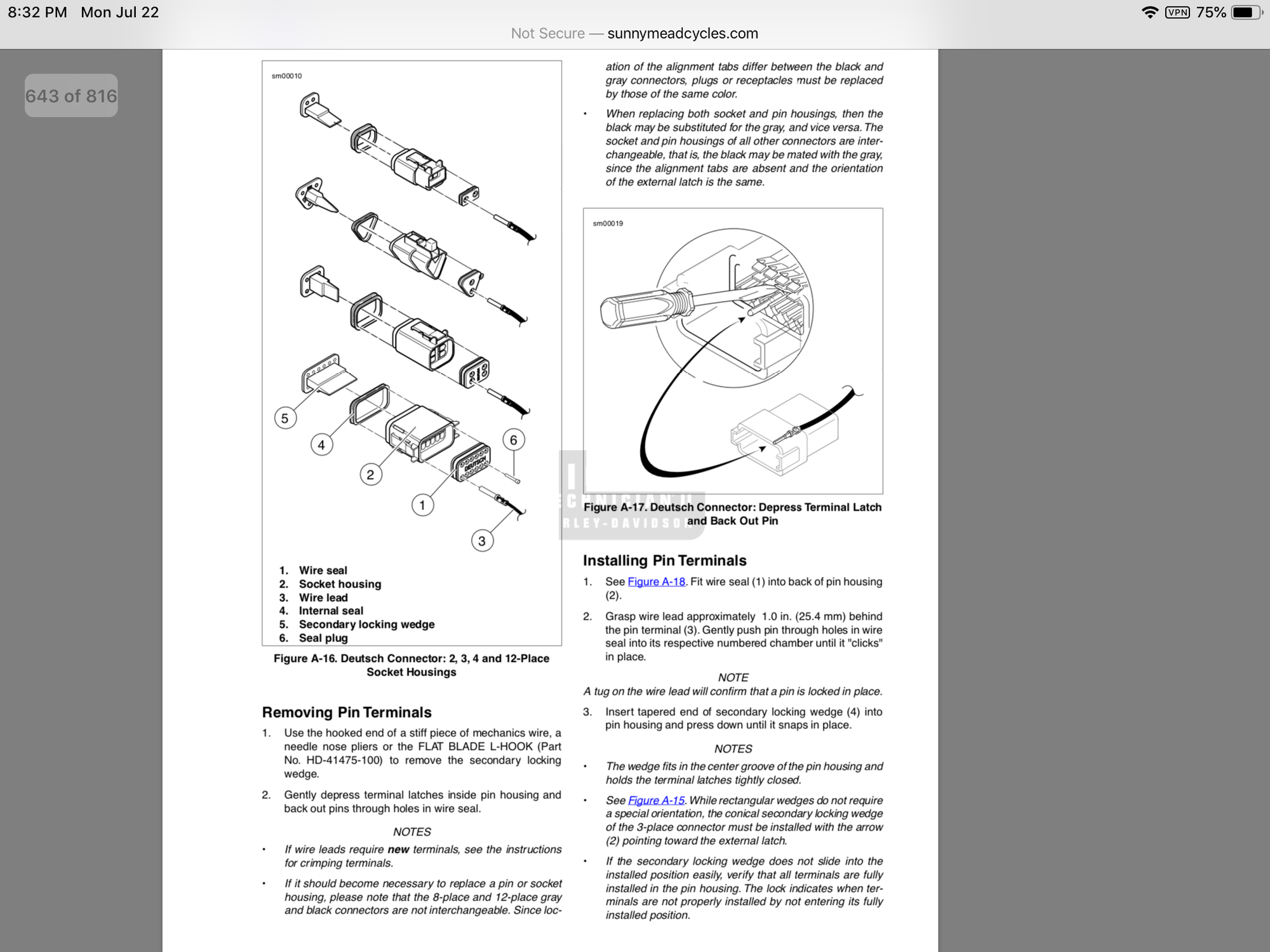

This is just one of the many "How to assemble a Deutsch connector" videos on youtube...
