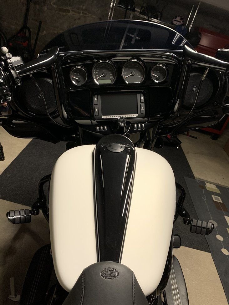

The bars they are doing in the video are 14's, this is not required for 12's. I recently put 12 inch factory 47's on my 2019 cvo sg, everything fit just fine. I did flip the wires around like the video shows to give the proper length. The hardest part of the job (for me) was pulling the wires through the bars, I have stock heated grips so that made it a little more difficult. Patience is key but I would not hesitate to do another set. The factory 47 video carried me through, this was my first set of bars I've ever installed myself. Good luck sir!

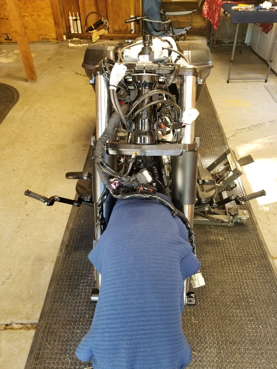

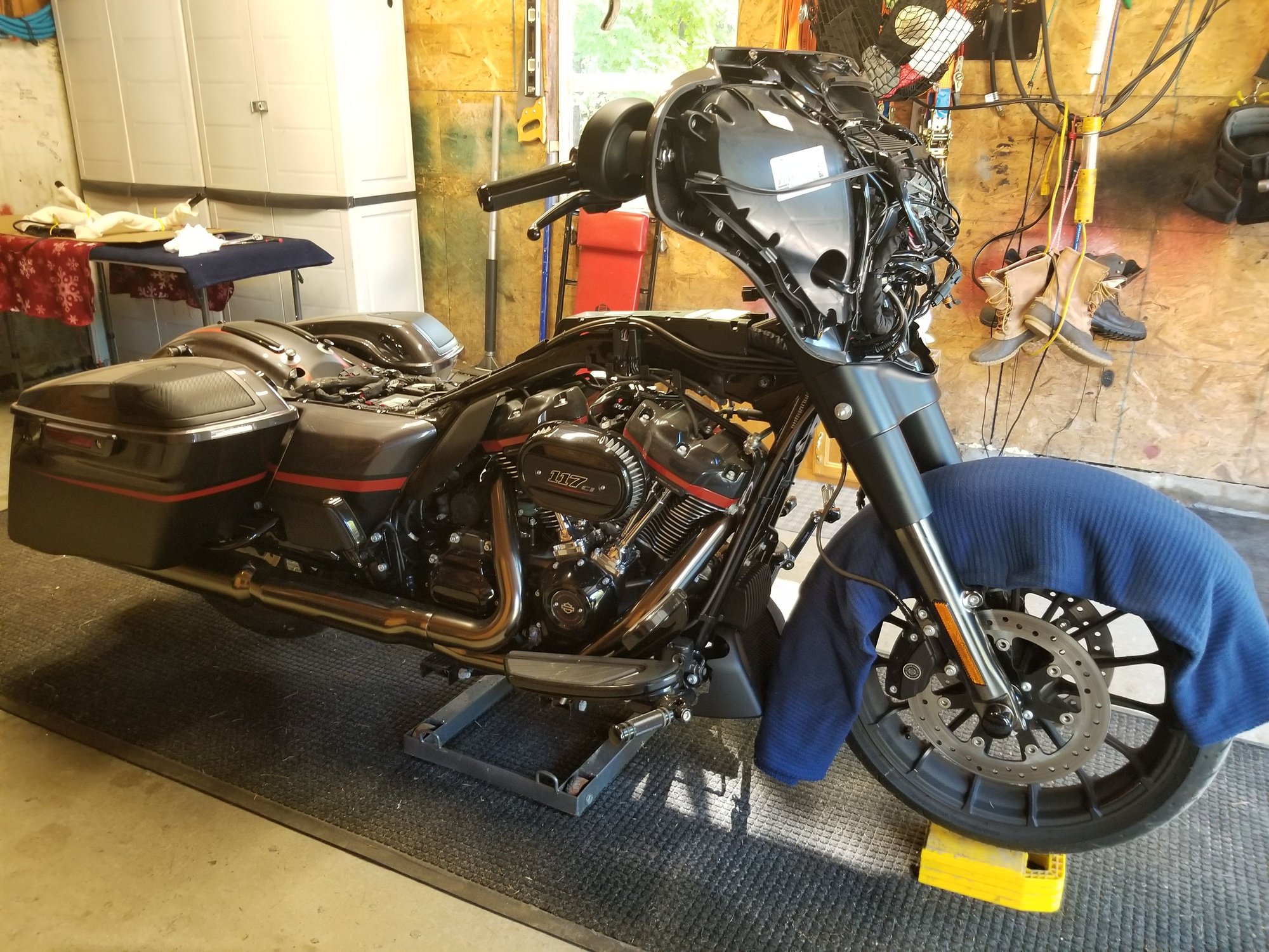

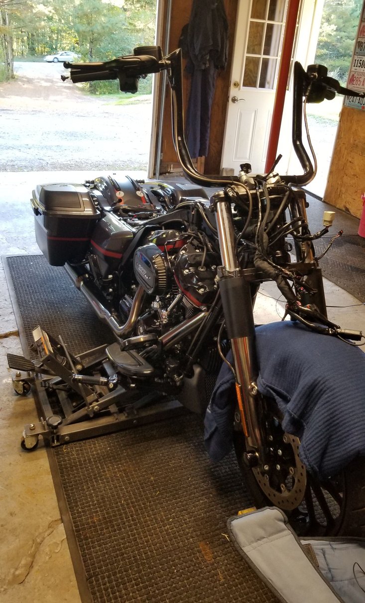

For those of you that are on the fence as to whether or not you should do this yourself, I say do it! I did alot of reading and watched a few videos, made a list of supplies I would need, TOOK MY TIME and took lots of pictures on my phone for reference. It took me longer than the average person because of two things: 1) I have a little mechanical/technical ability but removing pins and connectors had me doubting myself a bit. Theres a good technique shown on the Factory 47 video - 2) With the faring opened up and the gas tank off, I was able to clean areas I couldnt hit before. Snaking the cable thru was the most difficult part however, the right snake wire, taping and a little grease to help it slide and it was all over in about 20-25 minutes.
