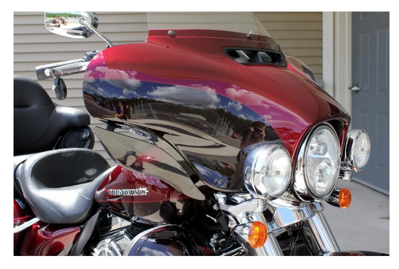

i do have the triple tree deflector already and the wind deflector on the fairing seen in pictures
the wind is not coming from tank already did some playing around with that and found that if i put my hand just above the top of current windshield the turbulence goes away

You need a recurve windshield. The rule is to have the shield low enough to look over, at about the height of the tip of your nose. At that height, the recurve will throw the air over your helmet. It doesn't have to have a bunch of recurve, just enough to stop the shakes. Clock works makes their shields with a lot of recurve, others not so much but others like Freedom Shields or Long Ride Shields have enough to keep you from the beatings. Your bike should have come with 2 plastic deflectors that mount to the engine guard that help stop the air coming up from around the lower fairings.

Make sure your fairing vent is open. My sucks when closed and never an issue when open.
