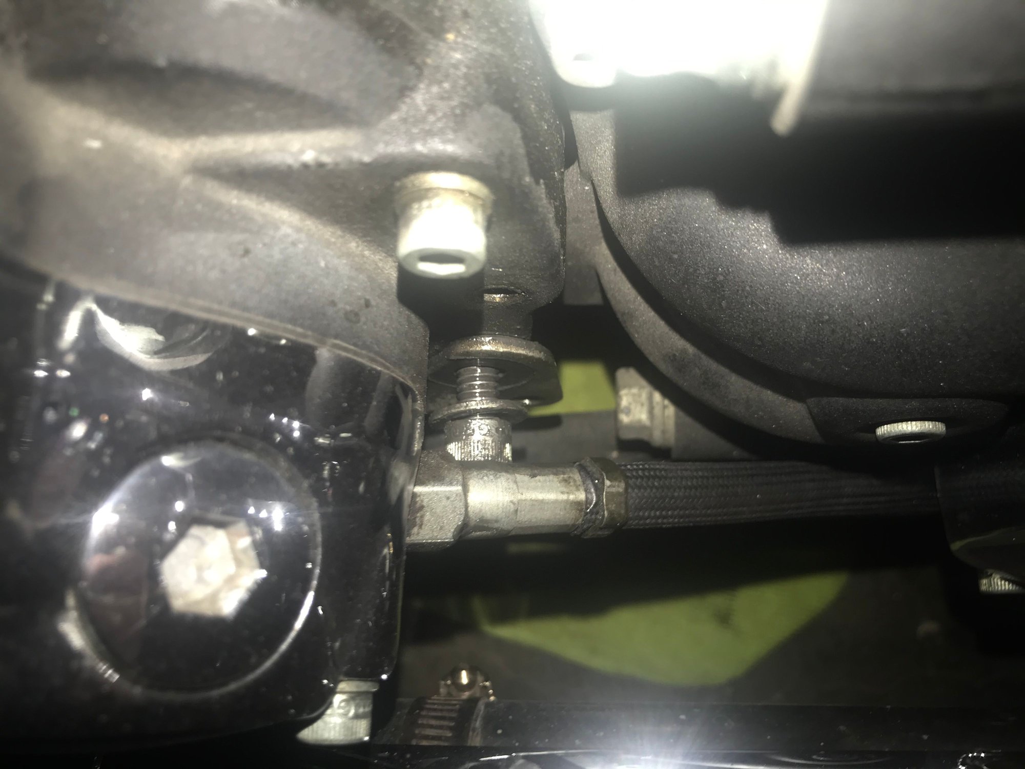

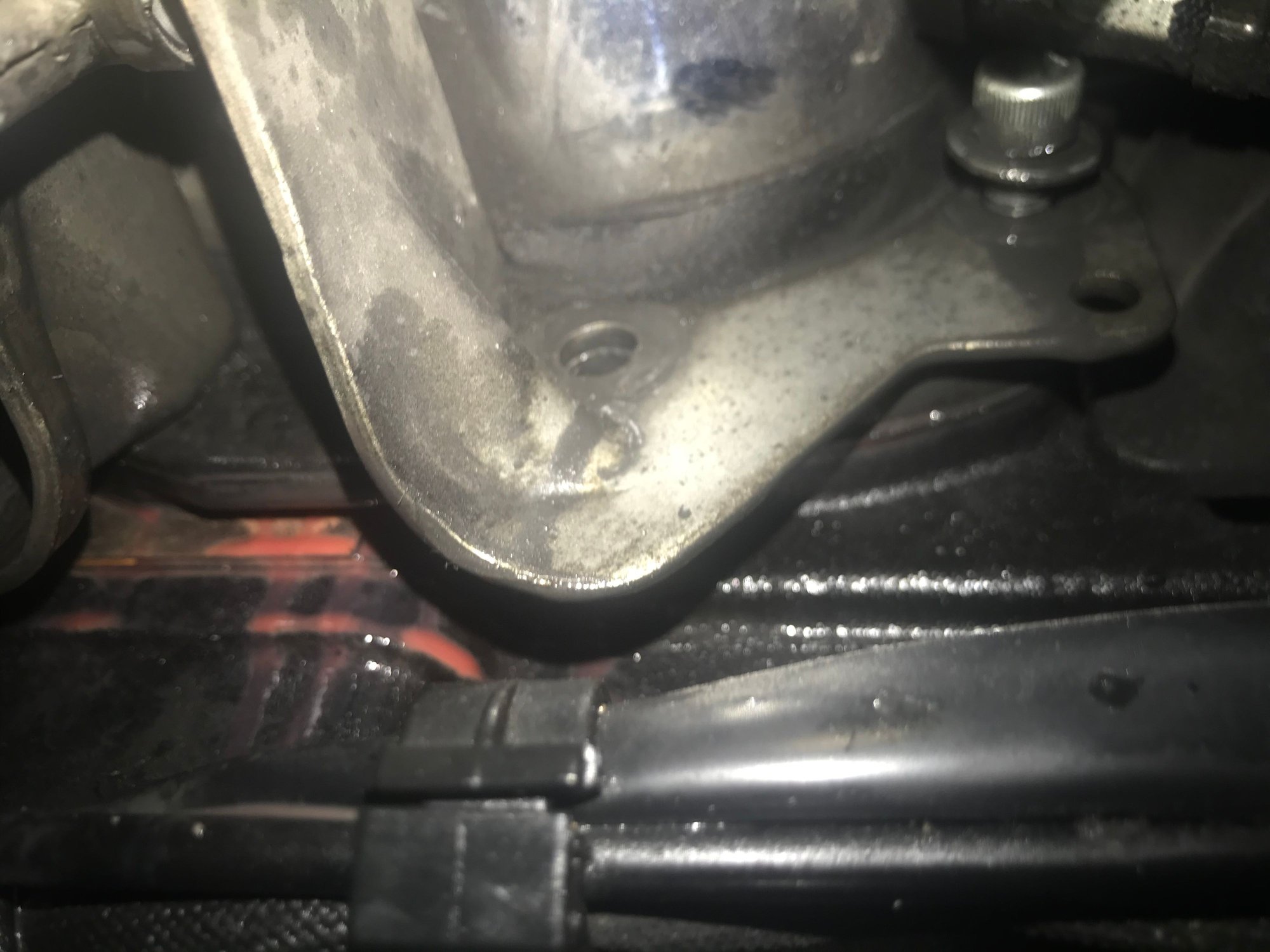

I lost a bolt and now it’s dripping oil out of it wondering if anyone knows the size of the bolt?
Bike - 2002 harley davidson flhrci road king classic
This one is with the bolt
This one without the bolt

Looks like #4 on this parts diagram http://partsfinder.onlinemicrofiche....0SIDE%20COVERS
Should be in stock at your local Harley parts counter.

5/16-18 x 1 1/4 grade 8 hex socket head
