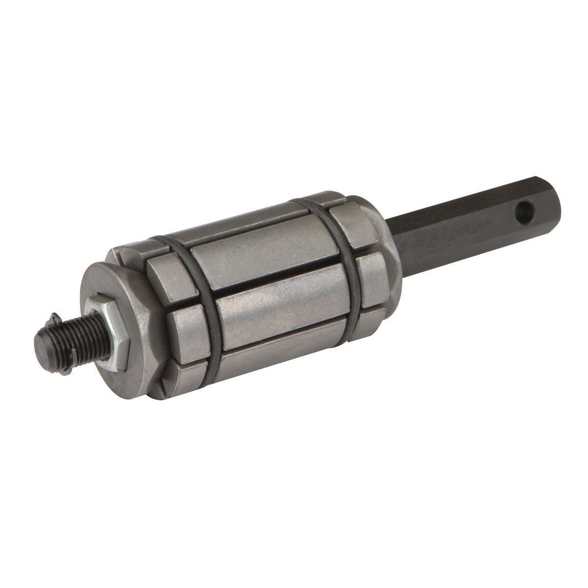

Jabmike, I kinda did the same thing on my bike the beginning of last summer, but different problem. My left side muffle would keep sliding off the head pipe. What a pita, I changed the clamp and that didn't help. So I used the same expander you did on the head pipe, a little at a time until if felt tighter. marked the pipe so I could tell if it started to move, almost a year later still on the mark.,,

Originally Posted by JABMIKE
Muffler end is out of round. I bought a pipe expander from Harbor Freight to get it back to round..
This is great tool ... but ... use with caution, especially on inlets with a notch / split on them
