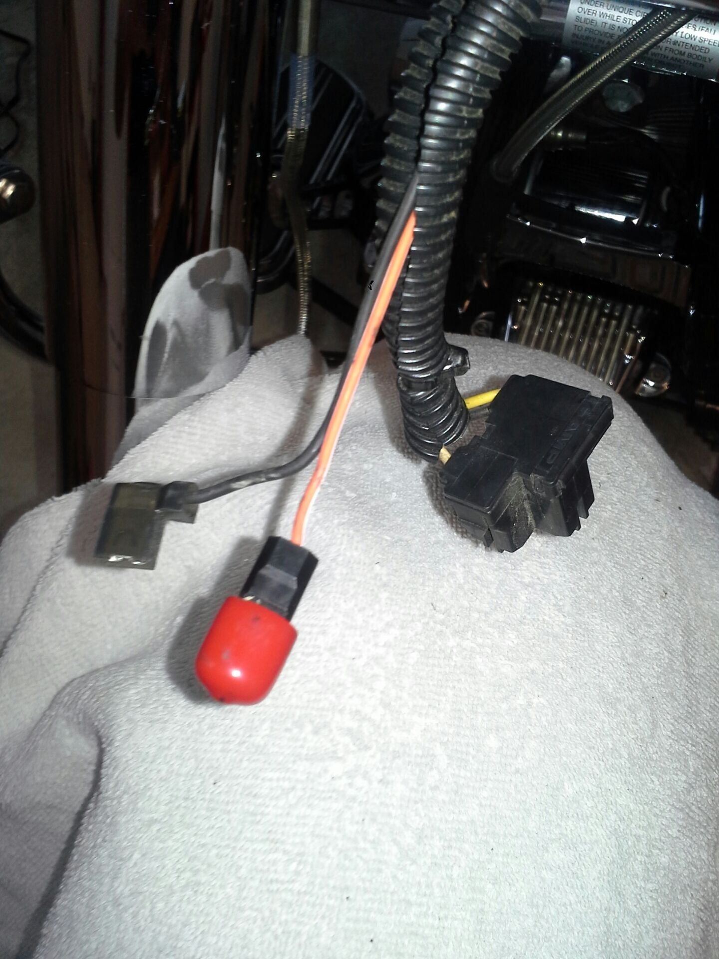

Mine is hooked up here:

[QUOTE=sanman4ever;18828936]Mine is hooked up here:
What is hooked up there? The headlight halo? Is that the wire to the accessory switch?

[QUOTE=JohnRW;18829298]
Headlight HALO, not wired to the accessory switch. Runs hot when ignition is turned on.

[QUOTE=sanman4ever;18829400]
Yeah I spliced mine into the low beam wire of the adaptor harness that came with the lights so its on all the time. Its the passing lamp halos I want to be on without the lamps being on.
