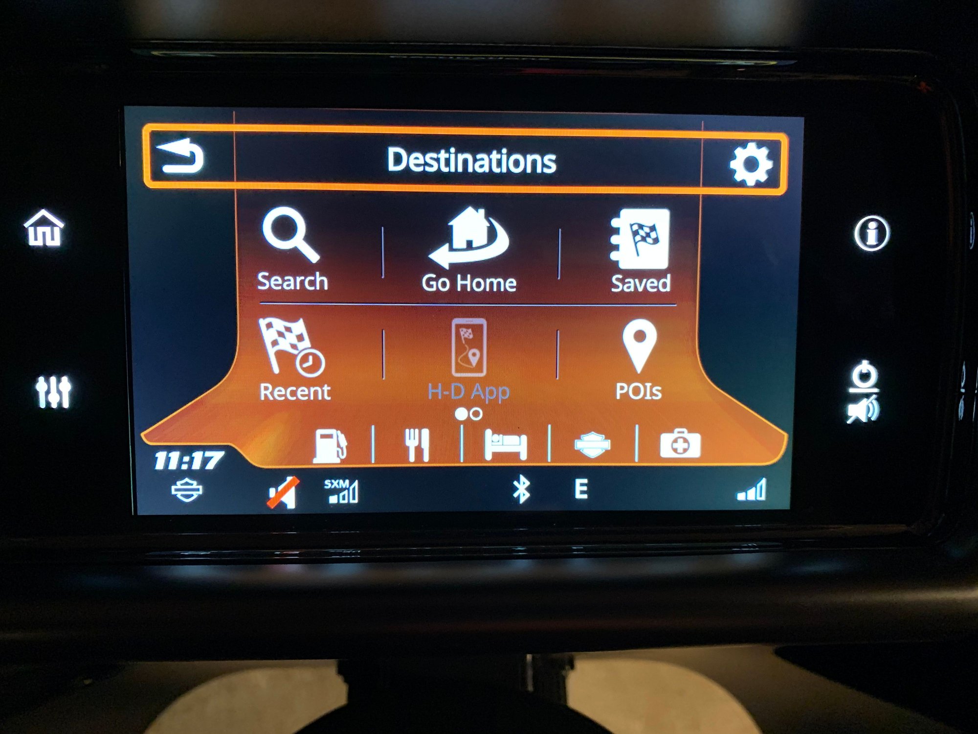

In your GTS Nav settings, turn it to off...
Start off from the Nav screen and click on the Magnifying Glass in upper left of screen.
On the Destination screen click on the Gear in the upper right
Then scroll down and set it to Off
